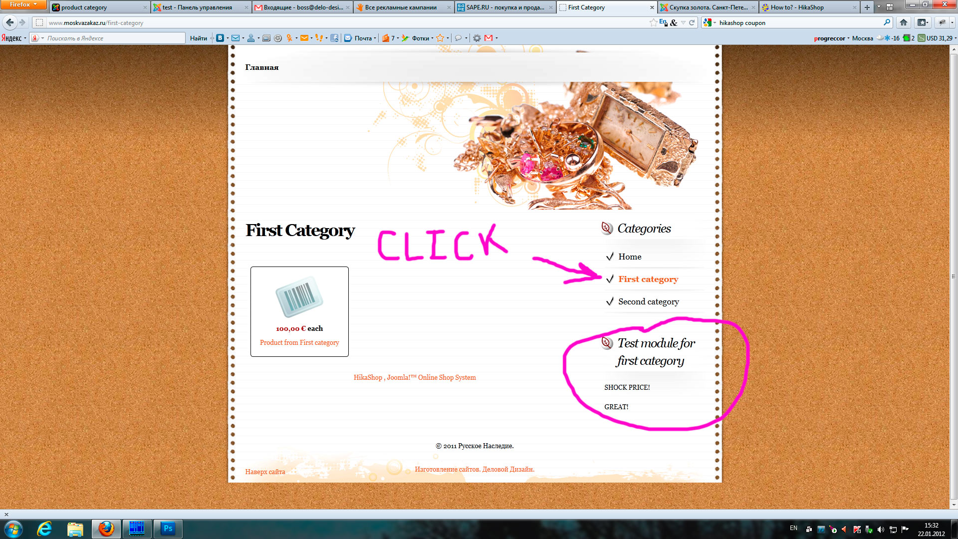

First of all let's I explain the problem.
Let's see to the typical hikashop site: www.moskvazakaz.ru/
here is the screensshot of it's main page.
the main page is hikashop categories listing. Great. We can see two categories.
And what if want to show one joomla module (may be shock price or something else) only on one hikashop subcategory?
I can create two joomla menues that lead to the same hikashop subcategories. Great!
If I click on the menu item it is all working.... but...
What if I click on the main page? I can see First category there too and may want to click there...
What a great disappointment! I can't see my module! Why?
Because joomla menu and hikashop categories have different adresses...

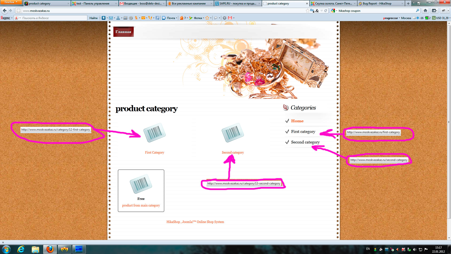

14 years 7 months ago #36263
here is how it must look

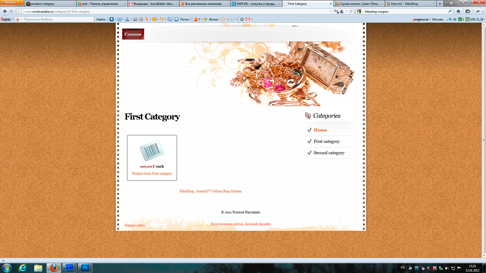

14 years 7 months ago #36264
and here is what I have if I click on the first category from the main page (not on the right menu)

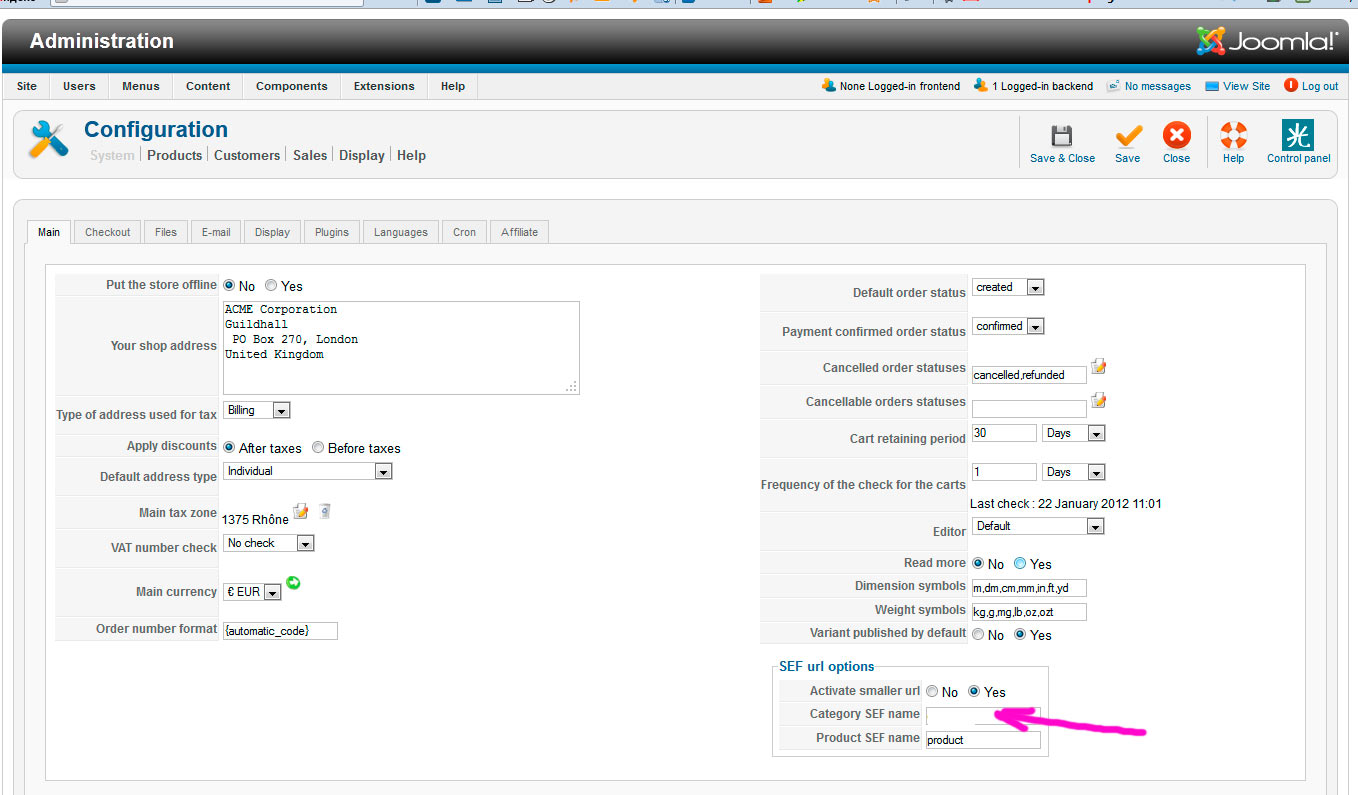

14 years 7 months ago #36265
Here is my way to solve the problem:
let's go to the hikashop configuration and in SEF url options clear Category SEF name
Я здесь добровольно!

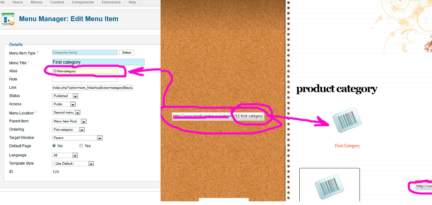

14 years 7 months ago #36266
After all let's go to the joomla menu item for the first category in the menu on the right of the site and set the alias for it the same as the last suffix of URL of hikashop category as you can see on the picture:
Do the same thing to the second category.
and voila...
It's all working!
What do you think, Nicolas, about this way to solve the problem?
you can see how it is working on this URL www.moskvazakaz.ru
