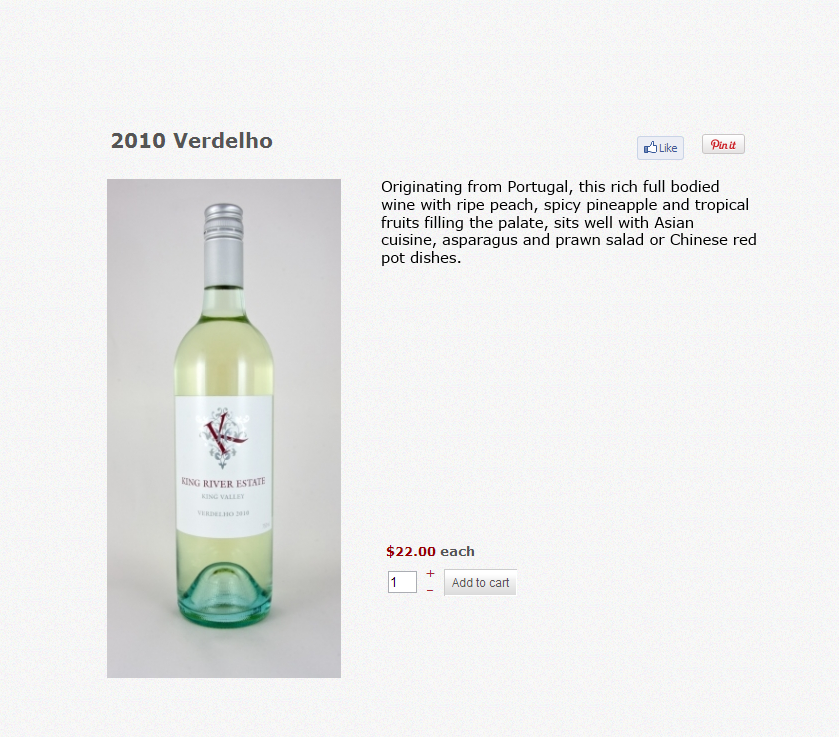

13 years 2 months ago #105680
I am trying to make this happen on Joomla! 2.5 and the latest version of HikaShop but I can't find which view to change it in.
What I need is the main image to be large, and not a thumbnail, and on the left, and then I want the text to the right of it with the description and then the "Add to cart" button below.
Also my social plugin icons are all out of shape.
Can you please help?
The website looks like this at the moment: tenillerogers.cloudaccess.net/wineshop/p...6-2010-verdelho.html
But I would like it to look like the attached.
  • Posts: 86042
  • Thank you received: 14175
13 years 2 months ago #105717
For the image, you can simply change the "product page image width/height" options of the configuration. There is no code to edit anymore.
For the positioning changes, you can move the different blocks of code of the file "show_default" of the view "product" via the menu Display->Views the way you want them.
  • Posts: 6
13 years 2 months ago #106109
nicolas wrote: For the positioning changes, you can move the different blocks of code of the file "show_default" of the view "product" via the menu Display->Views the way you want them.
I went into it and copy-pasted what I thought should change but I really don't know PHP very well.
I have copied:
<div id="hikashop_product_description_main" class="hikashop_product_description_main">
    <?php
    echo JHTML::_('content.prepare',preg_replace('#<hr *id="system-readmore" */>#i','',$this->element->product_description));
  </div>
And put it before the SPAN for the price in the product_right_part
But all it does is push the price and stuff from the right down to the bottom.
Please can you tell me what it is I need to copy and where I need to put it?
I'm really stuck :dry:
Last edit: 13 years 2 months ago by Nayeh.
  • Posts: 86042
13 years 2 months ago #106114
That's the solution actually.
What you're missing is that the description being too big for the right area, you need to add a CSS rule to force it on the right or it goes at the bottom because the description takes too much space.
So simply add that CSS and that should be enough:
.hikashop_product_right_part{ width: 45%; }
