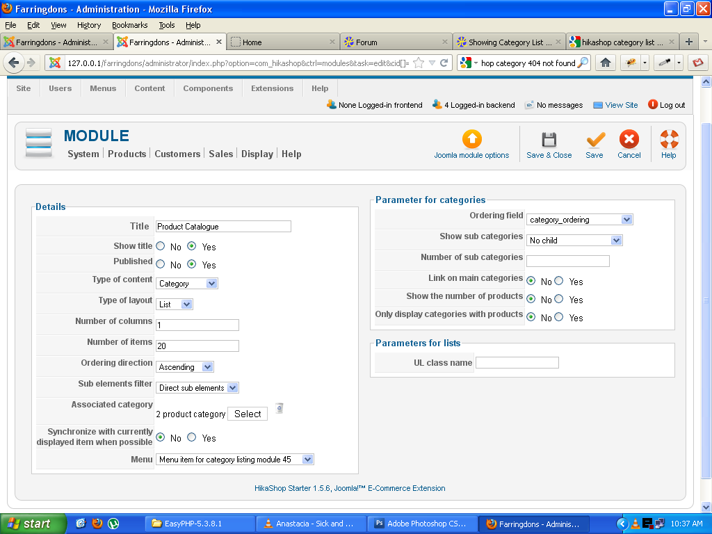

When I click on a categoru in the menu, I get a 404 problem.
On another post someone had the same problem, you said "Please make sure that you have a category listing menu selected as "menu" in the hikashop options of your module", but I do not understand this?
When I enter the "hikashop options" in the module that displays categories, on bottom left I have Menu - Menu item for Category listing module 45, is that what you meant or something else? (i do not see any other menu option here)
p.s. Are these the options you are reffering to?

AS you can see in the image above I have category listing under menu but it still doesn't work?
Or did you mean something else?

You settings seems indeed fine. You should try to first create a category listing menu as explained here:
www.hikashop.com/en/support/documentatio...html#categories_menu
Then, assign that menu to your module with the option you already found and it should then work properly.
