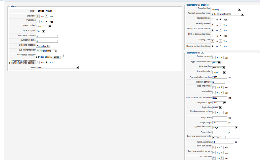

14 years 6 months ago #40992
find attached the screenshot.

  • Posts: 86179
  • Thank you received: 14216
14 years 6 months ago #40996
Regarding the dots not working, it's because you have javascript errors on your page related to an incompatibility between two javascript librarie, mootools and jquery.
You should try to install and configure the jquery easy plugin to fix that.
More information here:
www.hikashop.com/en/support/documentatio...ty-issues.html#modal
Regarding the slideshow not looping, it's the same on our demo website actually and there is no option to have it looping so that's normal.
