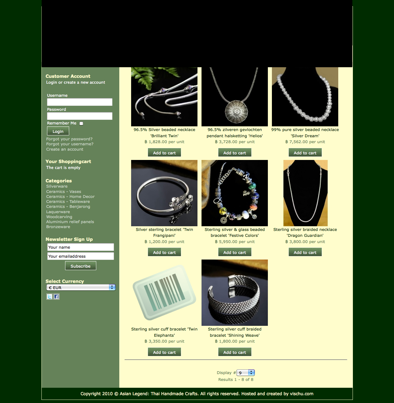

I'm trying to use the business edition auto currency update feature, but cannot get it working the way I have it in mind.
My base currency is Thai Baht. I have defined additional currencies to be Euro and US$. When I enter only Thai Baht prices in my products, on the product detail page it shows my product with the right price in either Euro or Dollars.
However when I show a page with all products in a product category, it shows all prices in Thai Baht, whateven the currency I selected in the currency selector. How can I show the prices there in Euro or Dollars too?

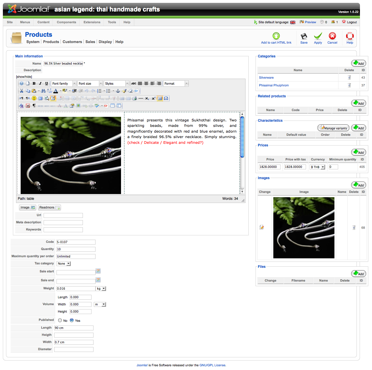

Anyway, this is the page that is causing me problems: www.thaihandmadecraft.com/cms/index.php?...re&Itemid=22&lang=en .
Attached are the pictures of the page and the productdefinition for the first product.
Hope you can find out what is wrong.
For the second: Any idea when this will be available?
Thanks again,
Gert.

15 years 7 months ago #4290
Here is the other image:

1. Could you try to change the file administrator/components/com_hikashop/classes/currency.php by the one in the archive enclosed ?
If that doesn't fix the problem, could you do a screenshot of the options of the module with the id 92 ? You can find them via the menu Display->Content modules and then click on the module 92.
2. We finished implementing the solution which is tested and working on our end. It will be available in next version which should be out next week.

maybe a helpful comment,
the currency does not change for me when viewing the category either... it just stays in Baht.
(on this page)
