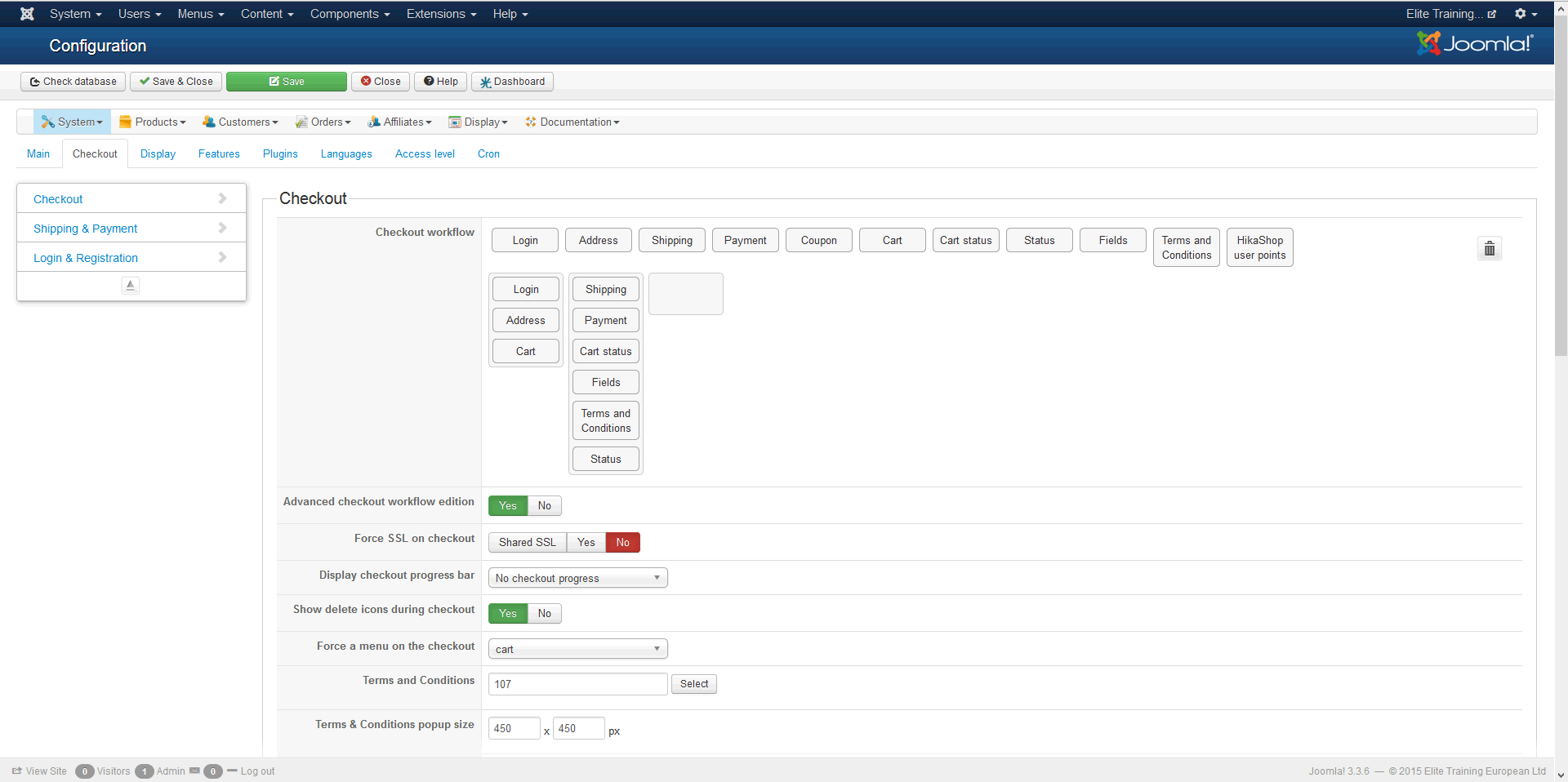

  • Posts: 376
  • Thank you received: 7
11 years 7 months ago #189247
Thanks for your reply. I thought I had configured in the correct way but it doesn't seem to work? (please see attached)

11 years 7 months ago #189274
In your case, your customers will have to select their address, and then go through the next step to select their shipping method, so can you give me more information about why it's not working ?

11 years 7 months ago #189787
If you want your shipping method to be displayed and preselected AFTER your customer has entered his address, you'll have to set the "address" action to a step before the "shipping" one through your checkout workflow via "Hikashop->System->Configuration->Checkout".
Note that I just did it for you.

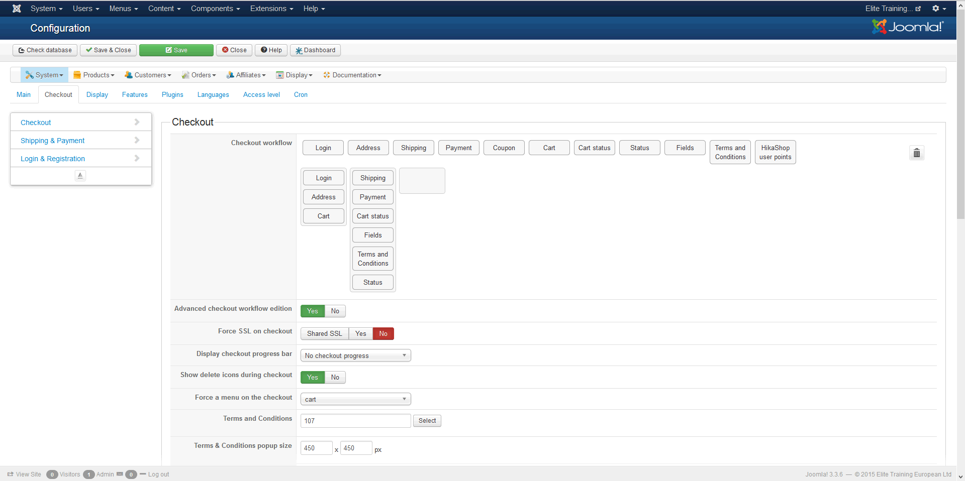

11 years 7 months ago #189901
I had already posted an image of the settings and they have not changed? Also the shipping is still shown in the cart although no shipping address has been specified. Sorry but I don't see this as fixed?
  • Posts: 26386
  • Thank you received: 4078
11 years 7 months ago #189975
Because you have the auto-select shipping and that HikaShop 2.3.5 has some shipping cache improvements ; the shipping auto selection can be made when the cart is displayed.
That's why, even if the user is not logged, HikaShop can select a shipping method if the rules are authorize him to select one.
We are currently performing a refactoring of the checkout system in order to provide more flexibility and to have less "strict rules" like that shipping selection.
Because some people want that the shipping be displayed as soon as possible and other don't.
In your case, if you don't want to let the shipping displayed in the cart before the step where the shipping is displayed ; best is to not use the auto selection of the shipping method.
