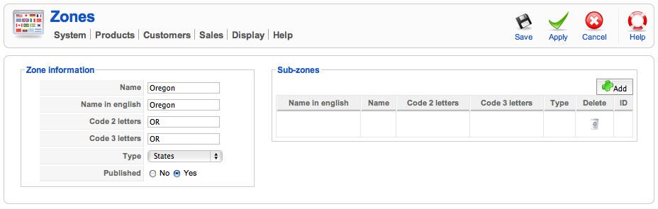

I have listed all the states to which we can ship wine (for now). The only one where the shipping address must pay sales tax is California.
Name in english: California; Name: California; Code 2 letters: CA; Code 3 letters: CA; Type: state; Published: check

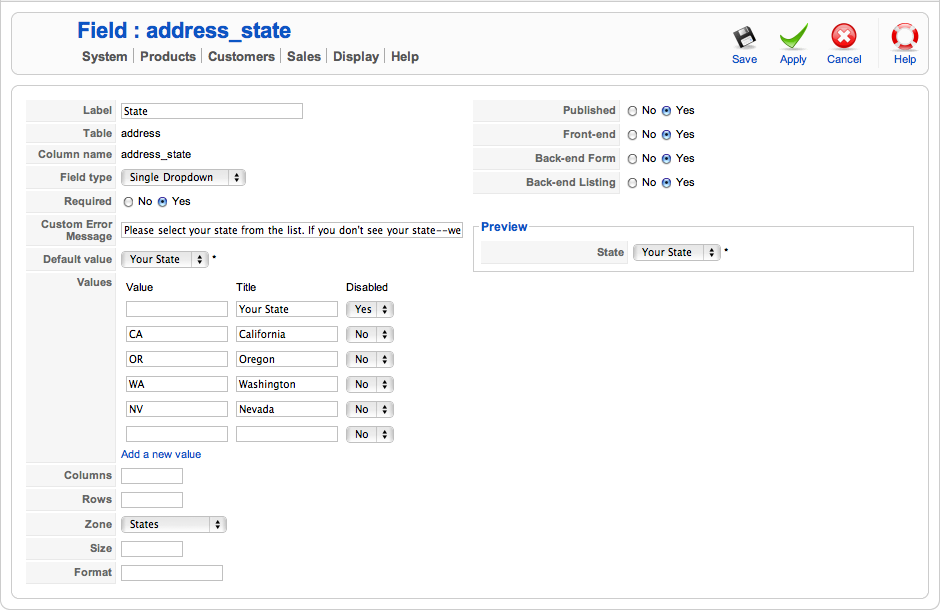

Display->Custom Fields
Table: address; Column name: address_state; Label: State; Field type: Single Dropdown; Required: check; Order: 8; Front-end: check; Back-end Form: check; Back-end Listing: --; Published: check; Core: check; ID: 12
I will also provide a screen shot of the various settings for the state custom field.

The problem is the custom field.
The default address state doesn't have the zone codes as value but the zone namekeys. That's why it doesn't work.
You should try to set the type of your custom field to "zone". If you want to remove states from it, you should just unpublish the zones via the menu System->Zones

Hm. So now the State field in the front end checkout disappears so the customer can't enter anything. How do I set the Zone information so that the choices appear here? (I deleted all of the bazillion states that came with the HikaShop plugin and added back only the few states to which I can ship. Sorry! I thought I was simplifying, not complicating.)

Also, make sure that the state custom field has the default options (you can look at our demo website for the default options).
