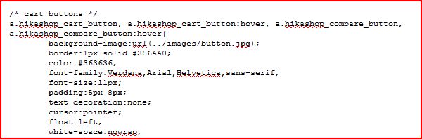

Now I've been trying to change the color/sizes off : ADD TO CART BUTTON
On Hikashop Configuration -> Display -> Front End CSS file to Custom -> (see attach.)
Tried to change color and font size, but nothings happeans :(

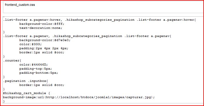

14 years 5 months ago #43663
Thank you nicolas.
But still struggling with CSS...
1 - I have inserted your code at the bottom of frontend_custom.css - Can i do that ? Place this code anywhere?
2 - I'm still in "learning/training" mode, so the path to my image should be from my localhost as I've inserted? (please see attach.)
Thanks in advance.
  • Posts: 86058
  • Thank you received: 14184
14 years 5 months ago #43664
Yes, it should be like that.
