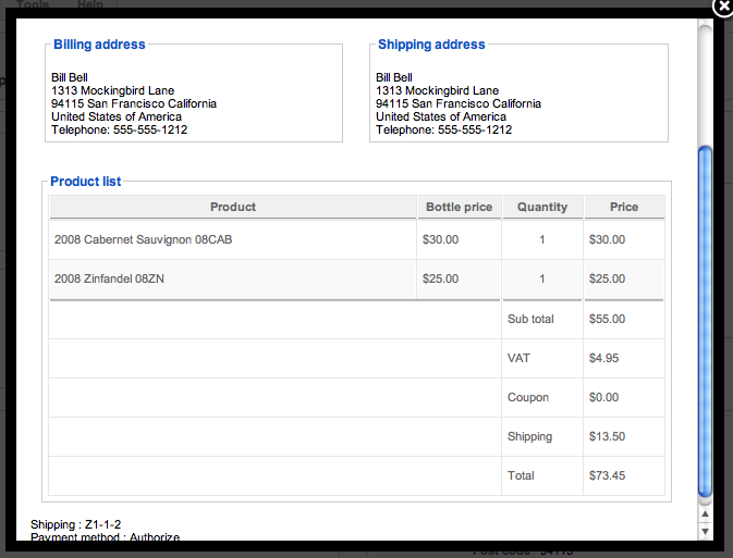

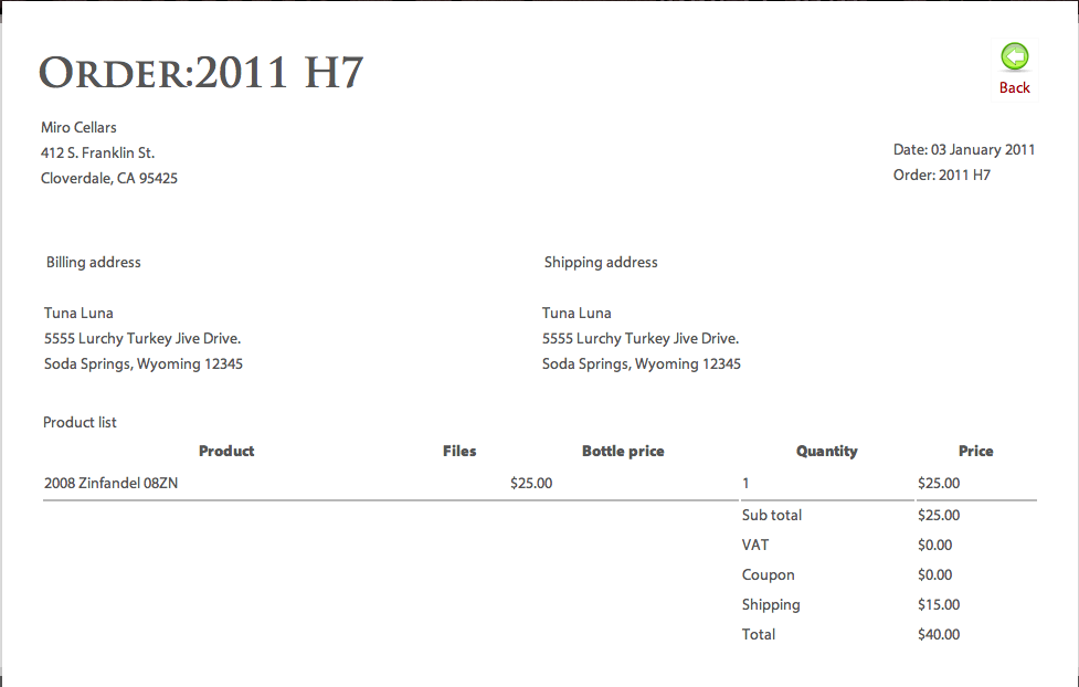

However, VAT's still in the customer's order page:
www.mirocellars.com/index.php?option=com...ask=show&cid%5B%5D=7 (username=Tuna; password=test or see attached screen shot)
...and I think that's all.
Nope!
Edited to add:
It's in the invoices: Sales->Order number->Invoice
Last edit: 15 years 7 months ago by mollyf. Reason: corrected mistake
  • Posts: 86042
  • Thank you received: 14174
15 years 7 months ago #4432
That one is the same as in the checkout and the email. So if it works there, it shuld here here as well.
Are you sure it's not a cache problem as well ? Or maybe you edited that view ?
