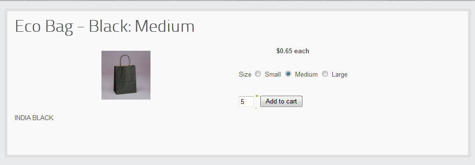

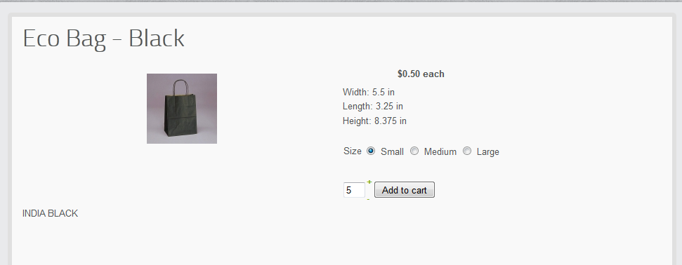

I have created products with three variants - small medium and large. each variant has its own price and dimensions.
The problem I have is the product displsy shows the dimensions of the default variant, but does not display once I click on another variant.
See attached - file 1 is the forst disp with def product variant.
file 2 shows what happens when I choose a diff variant.
Help pls...

Indeed, that's a bug in the current release. Please change the code:
		$this->setLayout('show_block_dimensions');
		echo $this->loadTemplate();
	</span><br />
to the code:
	</span>
	<?php
	?><br />
in the file "show_default" of the view "product" via the menu Display->Views and it will fix the problem.

  • Posts: 28
14 years 5 months ago #45544
Okay, this is partially working. The only problem is that the variation is not showing for the default option (before you click on one of the other variations). My default is small in this case, and small does not show up unless you choose another variation and then go back to small.
See ezecosmart.com (Eco Bags)
Thanks again in advance. I really appreciate your support
Mike
