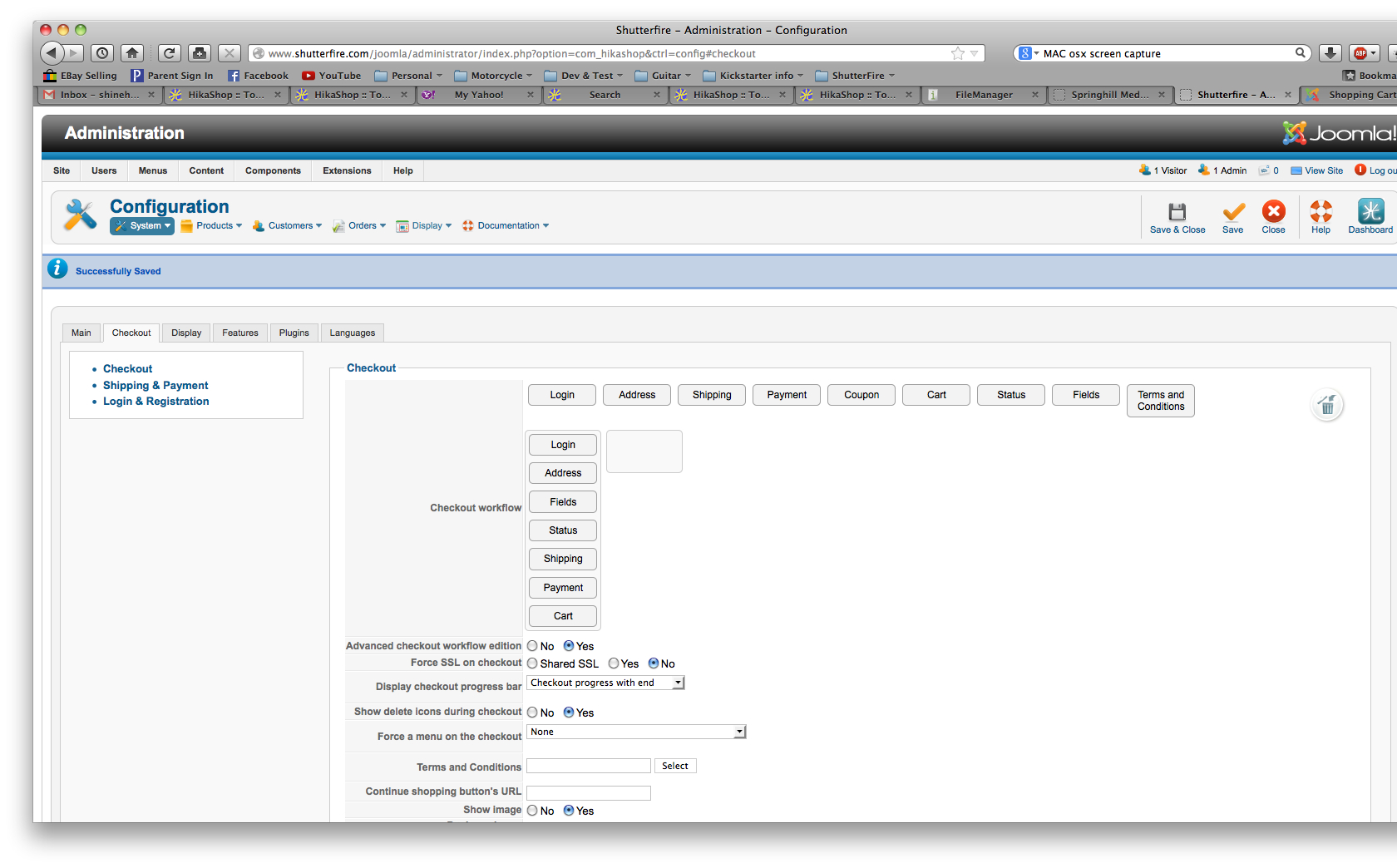

13 years 1 month ago #114075
I think that the problem must be cominf from your checkout workflow ("Hikashop->System->Configuration->'Checkout'") so can you show us how did you configured it through some screenshots for example ?
  • Posts: 25
13 years 1 month ago #114146
See the attached. I've tried moving payment before shipping and it didn't help.

  • Posts: 86176
  • Thank you received: 14211
13 years 1 month ago #114209
If the cart reloads the same page when you click next, it means that you're either missing shipping methods or payment methods.
You should get a message telling you what the problem is.
If you don't, it's probably because of your template:
www.hikashop.com/en/support/documentatio...issues.html#messages
Also, I invite you to check all the points of the FAQ which lists all the possible causes of shipping/payment methods not being found during the checkout:
www.hikashop.com/en/support/documentatio...ins-listing.html#faq
