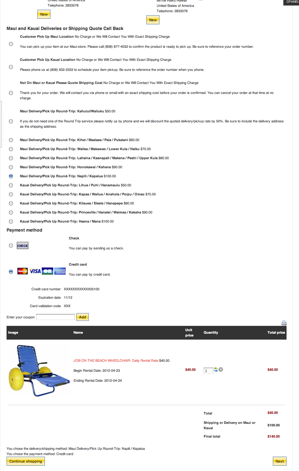

Can I pass the Manual Shipping Plugin variables selected at the time of Checkout to the Order, below or above where the Shipping Method: Price appears?
Now there is no detail given regarding the delivery option selected at checkout.
Could you give me location of the Summary of your Order email file and the code to change it. I have looked at the code and I my abilities are limited when it comes to writing the code. I can insert code...
Thank you very much.
  • Posts: 53
14 years 4 months ago #46646
Language file took care of most of the onscreen presentation. Still need to modify the Email notifications or Summary of Order.
Also View PDF icon is not showing all the screen information. It stop below price, needs to include the information on Shipping/Delivery that shows up below the final price.
Last edit: 14 years 4 months ago by teleactive. Reason: Added image
