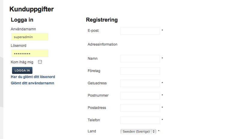

I want to create a simple checkaout flow. No registration. No Log in.
But the Log in module still turn up on when I go to checkout. How can I remove this or move it to an other position?

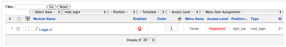

  • Posts: 86042
  • Thank you received: 14174
15 years 7 months ago #4782
What do you mean by login module ?
The joomla login module is independent from HikaShop. You can go in the joomla module manager to unpublish it or to publish it only where you need it.
  • Posts: 50
15 years 7 months ago #4784
I have disabled the Joomla log in module. Still it appears on my check out page. Se images.

15 years 7 months ago #4785
That is not the joomla login module but a part of the login view of the hikashop checkout. You can remove it following this post's instructions:
www.hikashop.com/en/support/forum/4-how-to/2486-login.html#2487
