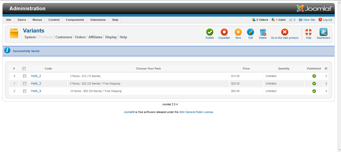

I think I figured it out. There are two areas where you set values for characteristics, in the actual characteristic settings, and then in the individual product Variant settings. I thought the value shown in the paypal check out was the one in the Characteristic ID. I just went to an individual product, clicked on Varient and notice there is the "Code" field that can be edited, I assume THAT is the one that shows in paypal check out. I will edit one then do a check out to see if the new value will show.
