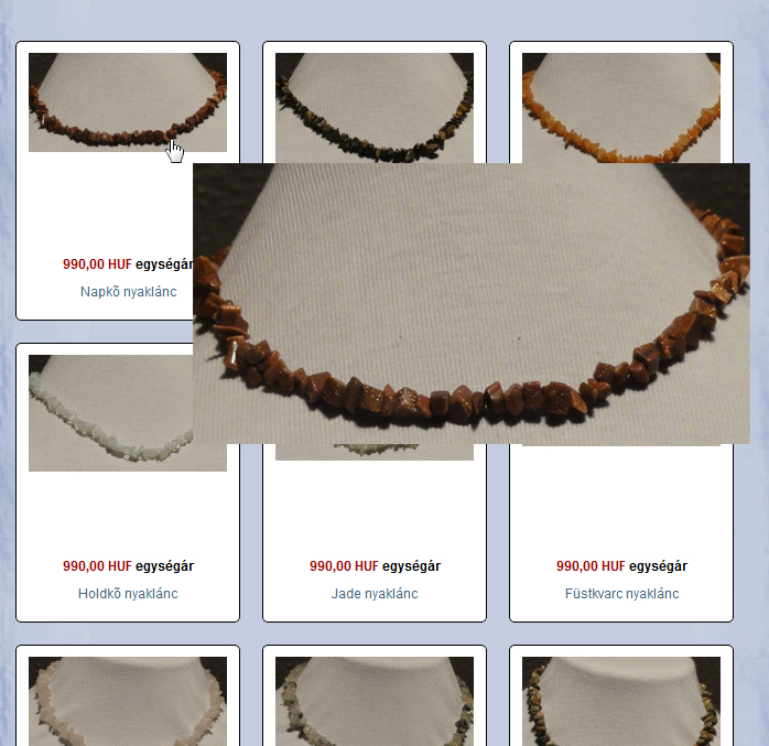

Dear Support,
I was wondering, is there a way to show the big (original size) image of a thumbnail with my mouse hovering over it on the products listing page?
I'm asking only, because my site will have many products, and going into all of them just so the buyer can look at the big picture seems like a hassle.
Thank you for the reply in advance.
I've made this example with paint:

It's possible with some code modifications.
Here is an example of such modifications on the product page:
www.hikashop.com/en/forum/4-how-to/42708...-product-images.html
For the listing, it's the same kind of modification that you need to do, change :
<a href="<?php echo $link;?>" title="<?php echo $this->escape($this->row->product_name); ?>">
	<?php }
		echo $this->image->display(@$this->row->file_path,false,$this->escape($this->row->file_name), '' , '' , $this->image->main_thumbnail_x,  $this->image->main_thumbnail_y);
	if($this->params->get('link_to_product_page',1)){ ?>
		</a>
to
	<?php
		echo $this->image->display(@$this->row->file_path,true,$this->escape($this->row->file_name), '' , ' onmouseover="SqueezeBox.fromElement(this,{parse: \'rel\'});return false;"' , $this->image->main_thumbnail_x,  $this->image->main_thumbnail_y);
but in the file "listing_img_title" of the view "product".

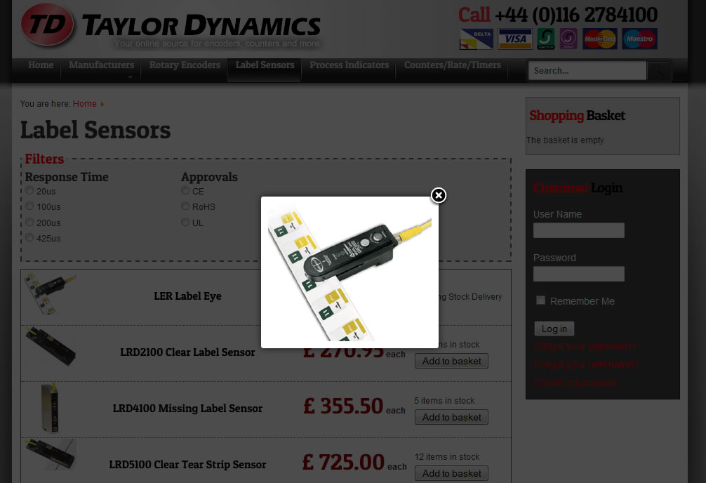

Hello!
I too, have a client who wants images in the products listing page to enlarge on mouseover. (Like this website: uk.farnell.com/jsp/search/browse.jsp?N=2...prevNValues%3D203450 )
I've added the code you suggested to the View > Listing_table. This works on hover, but opens the image in a shadowbox style view which then has to be closed using the X. I've added a screengrab showing this.
Can you advise?
Many thanks!
  • Posts: 26386
  • Thank you received: 4078
13 years 9 months ago #77092
The code that Nicolas gave was to open the Joomla popup window.
There is no library in Joomla or HikaShop to do the magnify like the screenshot. But some javascript libraries exists and can do it.
So, the code was just a base of idea, a proof of concept.
