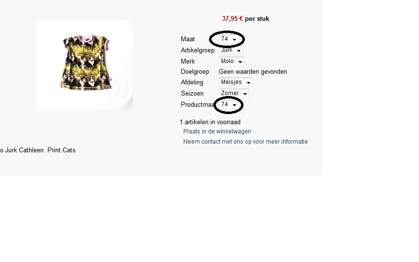

  • Posts: 252
14 years 3 months ago #50024
As I understand there are charactaristics which you can you for filters and charactaristics to select your size or color.
These last ones need to be on the productpage.
But the other whom to use for filtering I would like to hide/remove.
Do you now how to?
I also found out how to show the productcode on the productpage. But as we work with different sizes it show me the code from the child-product.
But I would like to see the productcode of the parentproduct.
And also have the text before that: Productcode
Last edit: 14 years 3 months ago by Boudewijn.

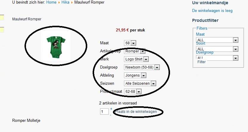

  • Posts: 252
14 years 3 months ago #50096
Hello Nicolas,
Where exactly do I need the place the code?
Is it in Configuration?
And how do I bring in the text? "Artikelnummer" before the productcode?
As for the Characteristics on the product page.
It look like in the file.
I think it is confusing for customers and it also gives a conflict in selecting the size.
For size I gave the product the correct size that is available.
And as we also have combination size (116-122 or XS/S) I gave the product a characteristic for filtering.
joomla25.dodowear.nl/index.php?option=co...pathway=2&Itemid=378
Perhaps is will help to see this.
Thank you, Boudewijn

  • Posts: 252
14 years 3 months ago #50320
Hello Nicolas,
I'm completly lost on this product variatiens. I used to work with VM 1.1.9 which is connected to my p.o.s. for managing my stock based on parent-id's and child-products. So far I didn't have any problems on getting this working.
But I don't know why I don't see how to get it working. I probably looking the wrong direction
And now it looks like I'm messing up my product table as well. One off the product has been copied 100.000 times.
It shouldn't be so difficult?
I ask you to help me to set up a product with different sizes as a parent product and a child-product.
and get these multiplied products deleted from the product table.
I would be very thankfull for that.
O, Find out that the varianties table has also created a lot of products of this product. But you would probelably understand why

  • Posts: 252
14 years 3 months ago #50729
Hello Nicolas,
Couldn't respond earlier on your note.
Thanks to your clear information everything is working the way it should be.
Thanks very much.
Boudewijn
