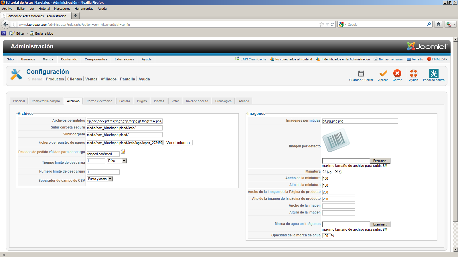

  • Posts: 6
14 years 2 months ago #50927
I attached screenshot of the options.
I not edited anyone views, and the last version are installed.
What has puzzled me is that in the other options, the thumbnails are displayed perfectly.
  • Posts: 86058
  • Thank you received: 14182

14 years 2 months ago #51305
Just add that CSS in the front end CSS file of HikaShop via the Display tab of the configuration and it should work:
.hikashop_child_image{ height: 100px; }
