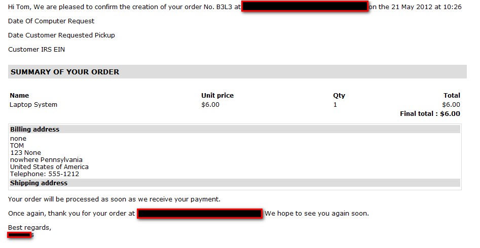

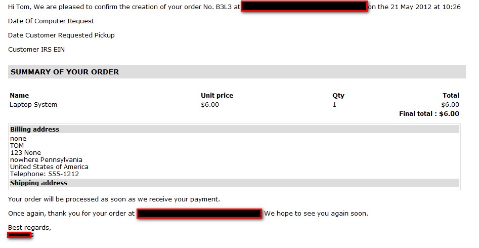

I have 3 custom fields that I want to display in the email. For some reason I can't seem to get it correct. I added three fields to the language file. I then added this to the email form and the language displays properly but not the data from the fields. Do I have the incorrect fields?
<?php echo JText::sprintf('CUSTOMER_DATE_REQUEST',$address->daterequested);?>
<br/>
<br/>
<?php echo JText::sprintf('CUSTOMER_DATE_PICKUP',$address-->pickupdate);?>
<br/>
<br/>
<?php echo JText::sprintf('CUSTOMER_IRS_EIN',$address->irs_ein);?>

<?php echo JText::sprintf('CUSTOMER_DATE_REQUEST', $data->cart->billing_address->daterequested); ?>
Doesn't work.
I see the Date of Customer Request title but no data from the address table daterequested field.. The placement on the email notification is exactly where I want them but no data.
Any thoughts.?
The three custom fields were added to the address table. Two date fields and one text field.

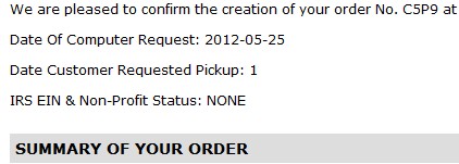

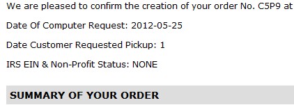

  • Posts: 23
14 years 3 months ago #51175
Semi-success. This code almost works. Except the pickupdate field only displays the number 1 but not a date. Daterequested displays fine and
so does Customer_IRS_EIN.

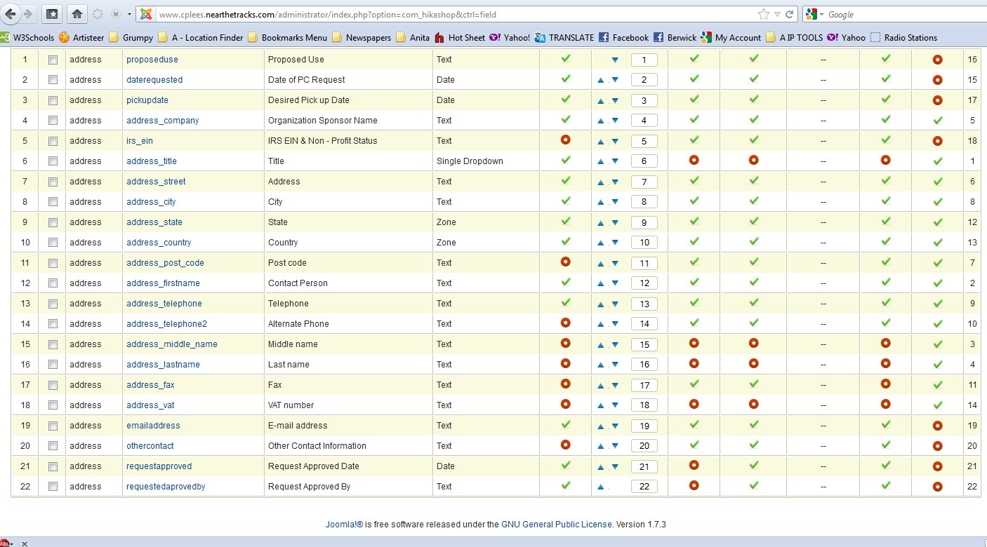

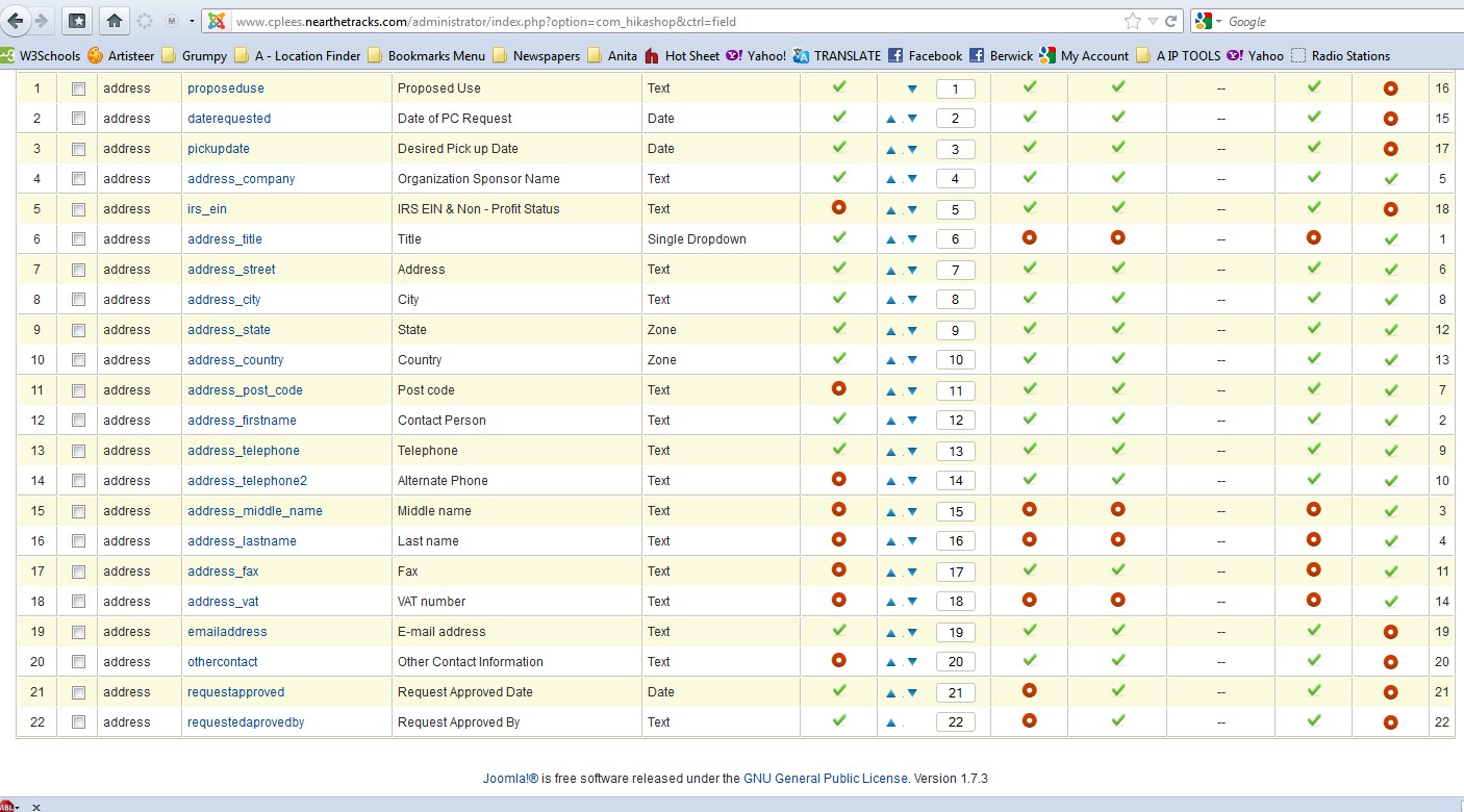

Can you do a screenshot of the options of your custom field ?
  • Posts: 23
14 years 3 months ago #51240
Screen shot of my custom fields
  • Posts: 86183
14 years 3 months ago #51346
It sounds fine.
