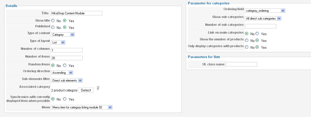

14 years 2 months ago #51977
I'm sorry but I find this menu really hard to create or I must be REALLY missing something 'cause I cannot get the categories to show at all. All that is showing is the title - no categories :(
Also, why does it keep creating modules, eg:
Associated products listing for category listing menu 137
Associated products listing for category listing menu 138
Associated products listing for category listing menu 139
Etc...
Please see attached pic.
  • Posts: 86058
  • Thank you received: 14182
14 years 2 months ago #52031
Your setup of that module is fine.

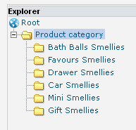

Could you do a screenshot of your categories listing on the back end ?
The problem must come from there.
  • Posts: 966
  • Thank you received: 11
14 years 2 months ago #52098
Here you go. Thank you!!
  • Posts: 86058
14 years 2 months ago #52182
And do you have products into these categories ?
You turned on the option "Only display categories with products " in your module. So if the categories don't have any products in them, you won't see them.
