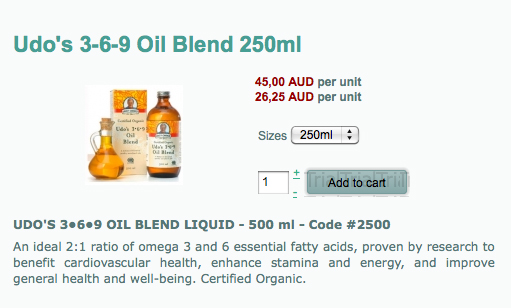

15 years 6 months ago #5203
it seems quite confusing
is there any full documentation for Hikicart?
I have added Characteristics of "size" with variants of 250ml, 500ml & 225gm
added it to the products
click manage and published 250ml & 500ml
now I get this (see attached)
how can I make it so that
1. The 45,00 appears as 45.00 ( ie "." instead of "," )
2. have the size/price appear together - eg " 500ml 45.00AUD per unit "
also is it possible to remove the "per unit"
Also, once operational, there will be possibly 100's of different sizes over the range of products - do I add all sizes to the one size Characteristic?

I see that you set two unit prices for your product. That is not possible. You should set only one unit price per variant. You can have a look at our demo website:
www.demo.hikashop.com/index.php?option=c...ow&Itemid=57&lang=en
There, the price was added for each variant of the product. The price is automatically updated based on the characteristic selected in the dropdown.
1. You can change the display format of your currencies via the menu System->Currencies
2. You can edit your characteristic values to include the price in it. Then, you can hide the normal price displayed with some CSS in your template.
The "per unit" can be changed by editing the translations in the configuration under the tab languages.
You can create several characteristics, with the same name if you need that, and add the relevant ones to your products.
