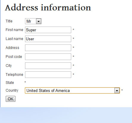

I also have what appears to be rows for US states but no information contained with in them. Thus when I set custom field, address_country to united states when I try to add an address on the front end there is no way to select the state. Presumably it is supposed to populate a dropdown box.

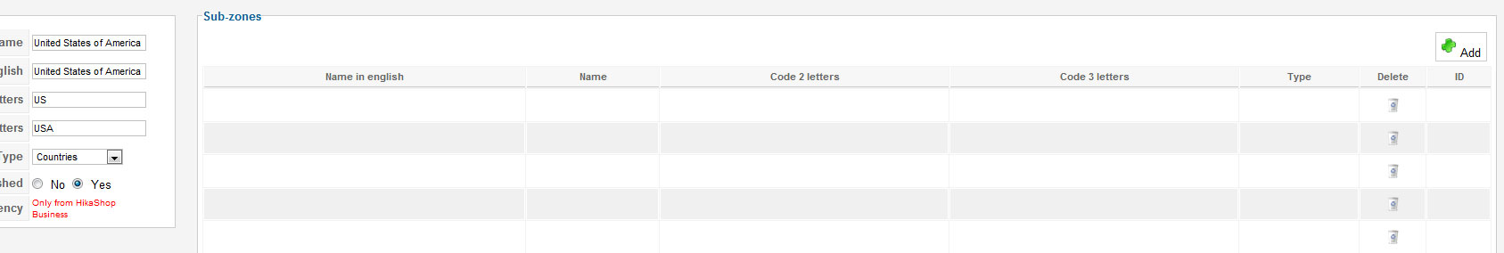

However, I still see extra rows for states in the zone_link table but no actual states listed for the US. (appears to return rows with empty data in the back-end due to the zone_link table). I was looking directly at the tables with HeidiSQL.

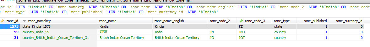

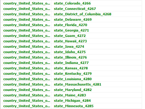

It was the browser cache, should have figured that one out on my own /facepalm. However I have rebuilt the zone and zone_link tables again and they are still incomplete for the US. I think its just missing from whatever file creates the tables in this build.
As you can see from the attached files zone_link has all the correct states, but zone does not have any (the query I did should have returned Indiana as a state) and you can see from the back-end screenshot that rows are created but there is no data in them. From the front end you can see that now state dropdown is populated when using zone and usa as country.

14 years 4 weeks ago #51911
We found the problem. Please download again the installation package from our website and install it on yours. That will fix the problem.

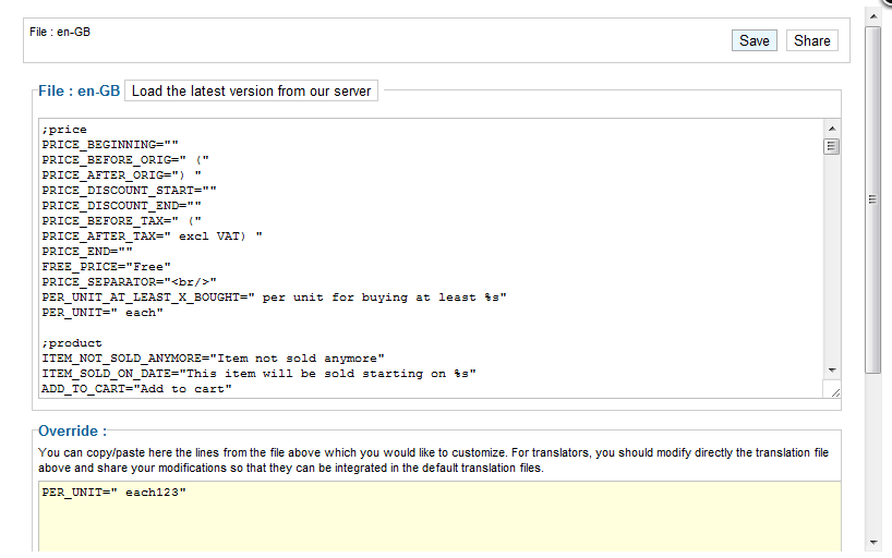

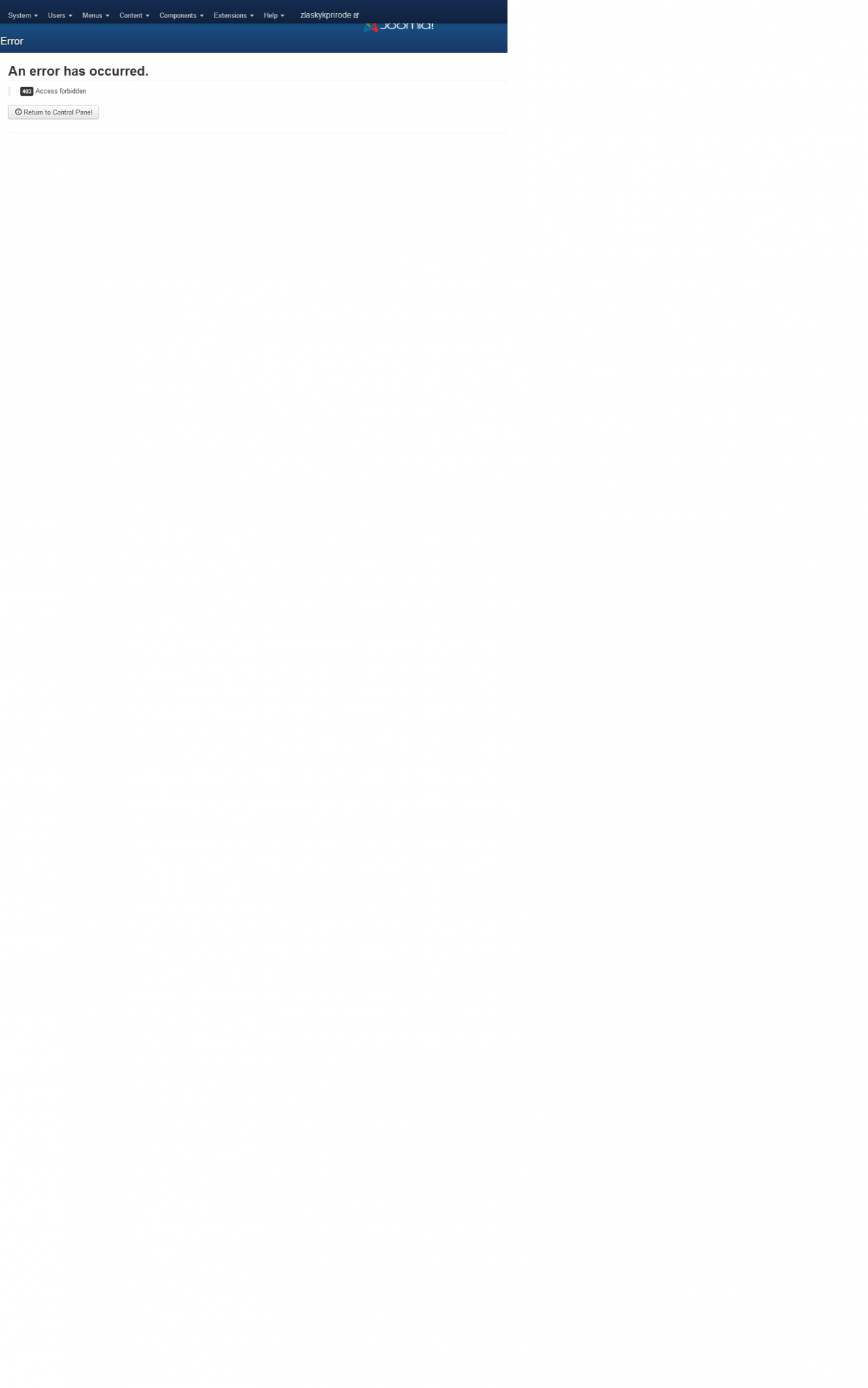

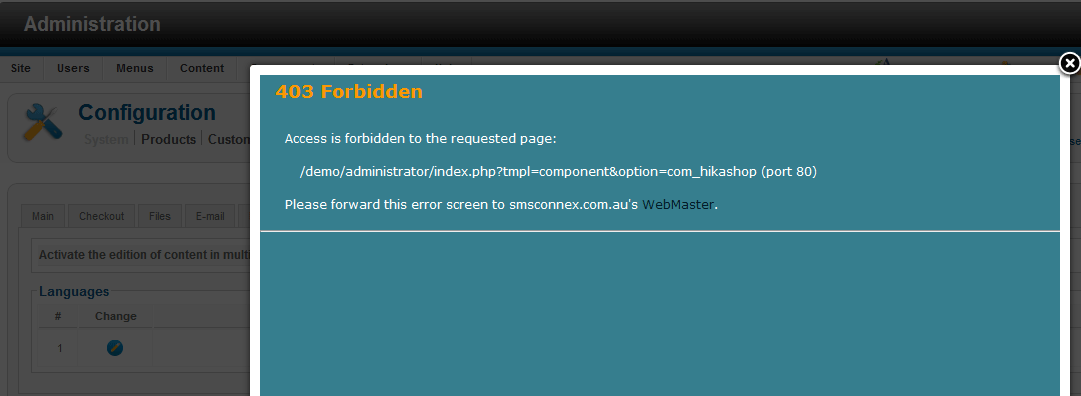

I need to update text in the translation override for English (GB) and getting the 403 Forbidden error.
Can you assist please Nicolas? :)

can you give more information ? A screenshot of the page before the error and one of the page after ?
Can you try to download again HikaShop on our website and reinstall it on yours ? You won't loose any data.
  • Posts: 2
13 years 11 months ago #58784
Hi Nicolas
I have version 1.5.8 (latest version I believe).
Example of override:
Error received:
I have purchased the Hika Styles add on but that will not affect this function I'm certain.
Any ideas? Is it a permissions issue on the webserver?
  • Posts: 85789
  • Thank you received: 14079
13 years 11 months ago #58809
Can you try to download again HikaShop on our website and reinstall it on yours ? Maybe a file went missing during the install.
It's not a permission issue on the webserver.
Also, note that the overrides can be configured via the language manager of Joomla since Joomla 2.5.0 so you might want to use that instead.

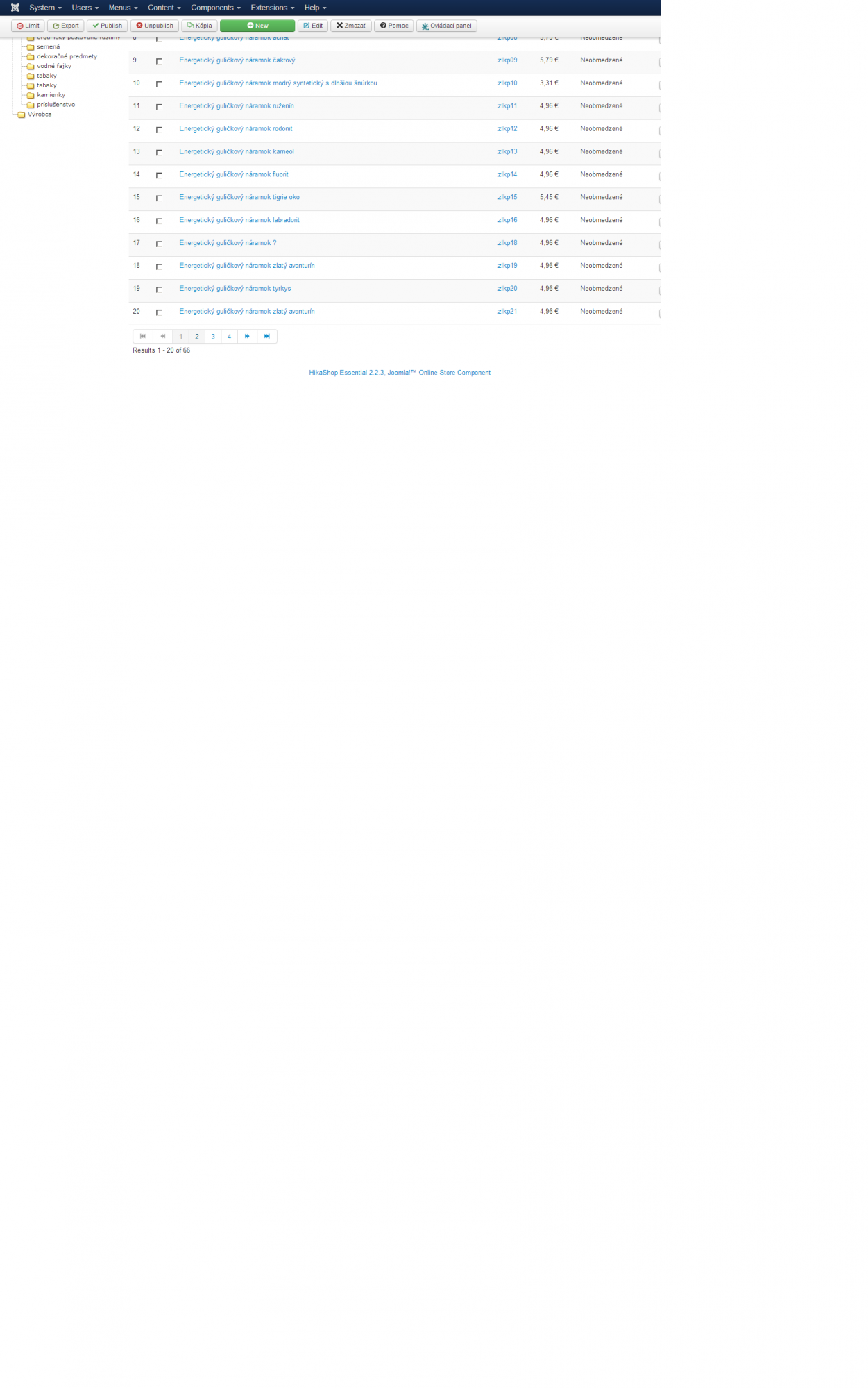

Hellou i got similar error but when i listing product and click on next page in admin drops out error 403 access forbiden.
And im super user.
It does even wheni edit product and click on close or use search in products.
Really dont know what to do. I tried to find solutien but i couldnt. I got newest hikasho essential.
Thx
  • Posts: 85789
12 years 6 months ago #136782
