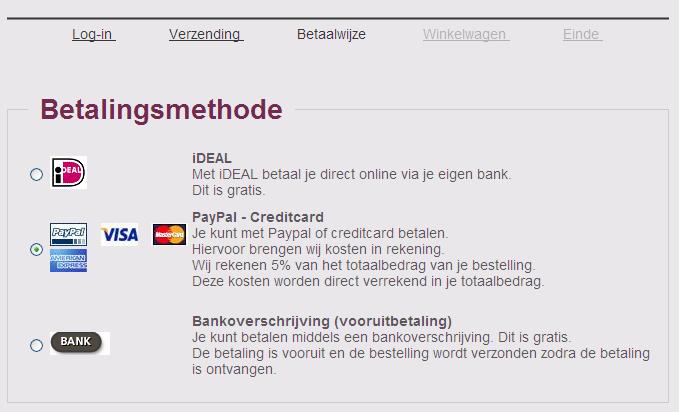

I did indeed add the 5% cost into the payment method.
In the checkout the costs are calculated, so this goes ok.

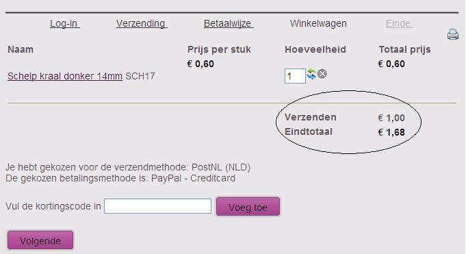

In pic4 you can see that i choose the paypal method (with the 5% extra cost).
In pic5 (if you would calculate it), the total costs are now including those 5%.
but .... i would like to see the costs to be shown seperately.
Just like you see now on the picture that the shipping is shown seperately, i would like to have an extra field with the paypal costs.
Does this make sense?? ;)

That's the case actually. You must have updated from a previous version of HikaShop and you had customized the file "cart" of the view "checkout" so you didn't get the new code which adds that line.
Revert your customization and reapply it to the new version of the file and it will work.
