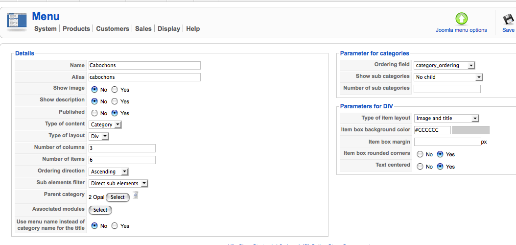

Great, I was able to access your website now. Could you go in the menu Display->Content menus and edit one of your menu and take a screenshot so that we can see the options you set for the menu ?
Also, a screenshot of your categories in the back end would be nice as I feel that you might have a problem with the categories.
  • Posts: 36
15 years 6 months ago #5910
Nicolas,
here are the screen shots.
thanks

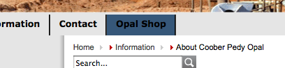

  • Posts: 36
15 years 6 months ago #5933
Nicolas,
answering my own post, don't bother to reply to my request for further assistance, I have made some progress. It's no way near anything that I would like but if it's all HikaShop can offer the so be it.
Now I need to know why the menu item Opal Shop (see attachment)remains highlighted when another menu item is selected.
thanks
David

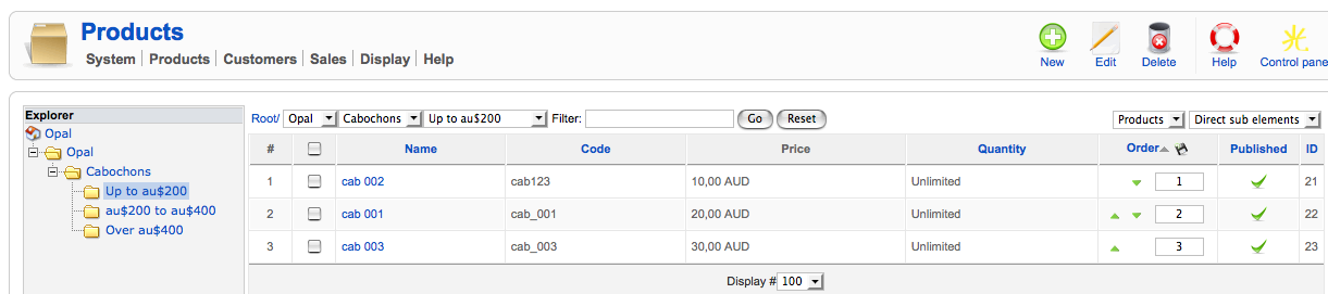

  • Posts: 36
15 years 6 months ago #5935
Nicolas,
spoke to soon, I did have a product showing, now ya see it now ya don't.
Please see screen capture of Products....... which do not show on site www.cpowd.com.cpo
guidance/advice would be appreciated.
David
ps I still need to know why the menu item Opal Shop remains highlighted.

  • Posts: 86042
  • Thank you received: 14175
15 years 6 months ago #5946
I went to your back end and setup three menus for you.
What you were missing:
1. Each of your menus needs to have the module "cab 001" published under the associated module option of your menu's hikashop options (you can access them via the link on the right when you edit your menu).
2. Each of your menus needs to have the correct category selected in the "parent category" option of your menu's hikashop options (you can access them via the link on the right when you edit your menu).
I've done that for these menus and it's now displaying the menus items properly.
