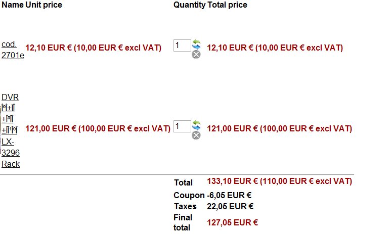

14 years 2 months ago #56420
I still have some problem after this change.
If I order two items:
- 100 euro, full price
- 10 euro with a 50% discount coupon (Coupon percentage applies to product only to yes)
I get:
total: 110 euro
discount: 5 euro
vat (21%): 23.1 euro (=110*0.21 instead of 22.05=105*0.21)
final: 128.1 (=105+23.1 instead of 127.05=105+22.05)

  • Posts: 86179
  • Thank you received: 14217
14 years 2 months ago #56474
I tried on my end and I get the correct result without any code change:
I set the discounts to be before taxes in the configuration, the coupon to be in the tax category and the products with the exact same settings than you did.

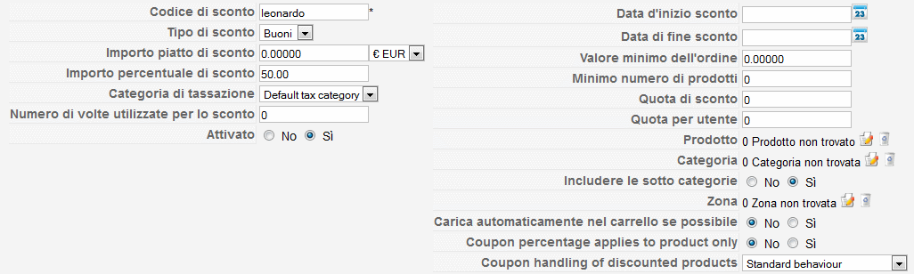

  • Posts: 86179
14 years 2 months ago #57027
Can you do a screenshot of the options of your coupon ?
So that we can try to reproduce the problem.

  • Posts: 19
14 years 2 months ago #57751
nicolas wrote: Can you do a screenshot of the options of your coupon ?
This is the coupon when no product/category is specified.
The other coupon is the same except product or category and "Coupon percentage applies to product only" set to yes.
