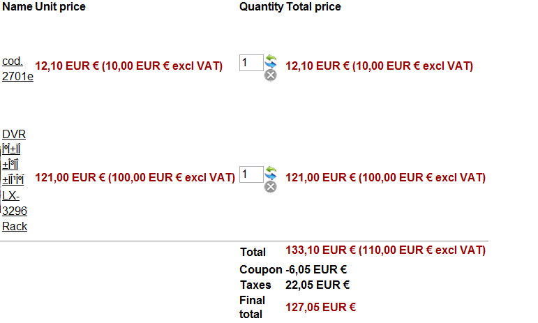

  • Posts: 19
13 years 11 months ago #56420
I still have some problem after this change.
If I order two items:
- 100 euro, full price
- 10 euro with a 50% discount coupon (Coupon percentage applies to product only to yes)
I get:
total: 110 euro
discount: 5 euro
vat (21%): 23.1 euro (=110*0.21 instead of 22.05=105*0.21)
final: 128.1 (=105+23.1 instead of 127.05=105+22.05)
It looks like
$discount_tax = $cart->coupon->total->prices[0]->price_value_with_tax-$cart->coupon->total->prices[0]->price_value;
is making a wrong calculation, especially the value of price_value_with_tax which is calculated after taxes, even if I set the Apply discounts before tax.
How can I change the code to make price_value_with_tax and discount_tax work as expected?
Thank you!
  • Posts: 85796
  • Thank you received: 14090
13 years 11 months ago #56474
I tried on my end and I get the correct result without any code change:
I set the discounts to be before taxes in the configuration, the coupon to be in the tax category and the products with the exact same settings than you did.
  • Posts: 19
13 years 11 months ago #56507
nicolas wrote: I set [..] the coupon to be in the tax category
That's what I missed!!
Thank you again for your great support!

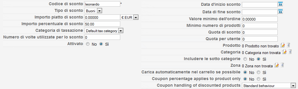

  • Posts: 19
13 years 11 months ago #57751
nicolas wrote: Can you do a screenshot of the options of your coupon ?
So that we can try to reproduce the problem.
This is the coupon when no product/category is specified.
The other coupon is the same except product or category and "Coupon percentage applies to product only" set to yes.
