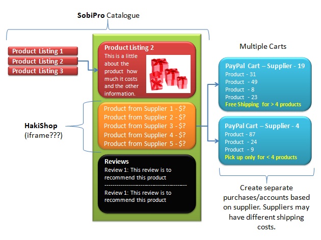

Hello All,
I am new to Hika. I have downloaded a copy for testing and it looks great, simple to use and supurb admin layout.
I am at the design and testing stage so I hope you can help with some information so I can better understand how it might suit my needs.
We are an aggregator, we sell products for other suppliers so firstly we have to seperate purchases by suppliers.
Secondly the products can be common so product A has multiple suppliers.
Thirdly the products are heavy so shipping is an issue and a min order is normally required to make shipping worth while.
In short, a consumer can search the site and select 7 products from 3 suppliers. If one supplier is shipping 4+ products they will do this for free. The other two suppliers would need to charge, charges are expensive so a pick up is the only real option. Suppliers may have different shipping terms.
Firstly I need a searchable catalogue and we are thinking of SobiPro, however it does not handle purchases!
Secondly we need to list suppliers of the selected product and Haki looks very strong.
Thirdly we need to seperate the purchases (by supplier) so there is not confusion on behalf of the consumer as to what the shipping charge will be. I imagined multiple paypal carts???
This picture should help clarify my comments.
My question is, is this possible with Hika as I would like to invest and test further.
Thank you
Dom
  • Posts: 86042
  • Thank you received: 14174
15 years 6 months ago #5358
HikaShop doesn't handle yet suppliers nor does it handle multiple shipping costs for an order, so it's not possible to set several suppliers with different shipping costs.
However, you could create your own shipping plugin, based on the manual shipping plugin we have. In the plugin, you could get the products information and calculate the total shipping price based on the supplier's costs for the products, you could use custom product fields to add more information to the products like the supplier, the supplier shipping costs, etc.
There should be only one payment for the customer so you should keep only one order in hikashop. I don't know how you want to notify the suppliers ? Automatically ? With an email ? In such cases, you could do that in your plugin as well.
You can find more information about how to create a plugin on that page:
www.hikashop.com/en/support/documentatio...r-documentation.html

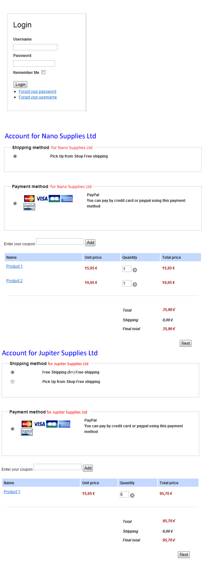

  • Posts: 11
15 years 6 months ago #5417
Nicolas,
A picture tells a thousand words...
The user pays each invoice seperately, for me this avoids the problem of a user selecting 6 products from 6 suppliers and expecting the "free delivery" option!
This does raise questions as to whether "suppliers" should be a table that "shipping" and "Payment Method" are then assigned to suppliers? But keeping it simple a field "product_supplier" and a checkbox "Select to seperate invoices by supplier".
Something like this... What do you think?
DM
  • Posts: 86042
15 years 6 months ago #5419
Mmm. It's not possible to have simultaneously several carts activated on the checkout.
In you case, I would modify a bit the cart module to display a listing of all the carts of the user, one per supplier. For each cart, the user would have a "proceed to checkout" button which would redirect the user to the checkout for that precise cart.
That way, that wouldn't require too much work. Basically, you would need to work on the cart module code to display the several carts per supplier. Then, the checkout would work normally.
