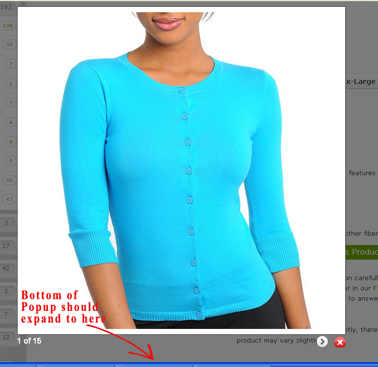

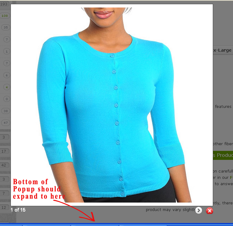

11 years 9 months ago #176068
Sorry to bother you but we are trying to get the pop-up image to fill up as much as the screen as possible vertically and just have a question.
We were able to get the image close to the top of the page but there is space at the bottom and we are not sure how to remove that space so the image can expand more.
Please see attached pic and thanks in advance!!
Last edit: 11 years 9 months ago by MyWorld.
  • Posts: 86045
  • Thank you received: 14176
11 years 9 months ago #176107
It's a bit complex to do.
If you're using the shadowbox external library that we provide for the images popup, then you'll want to modify the line:
$doc->addScriptDeclaration("\r\n".'Shadowbox.init();'."\r\n");
of the file administrator/components/com_hikashop/helpers/popup.php and add a viewportPadding parameter to the init function call as explained here: shadowbox-js.com/options.html
If you're using the extension shadowbox media player, then you'll have to edit that extension code to add the parameter to the shadowbox init function.
