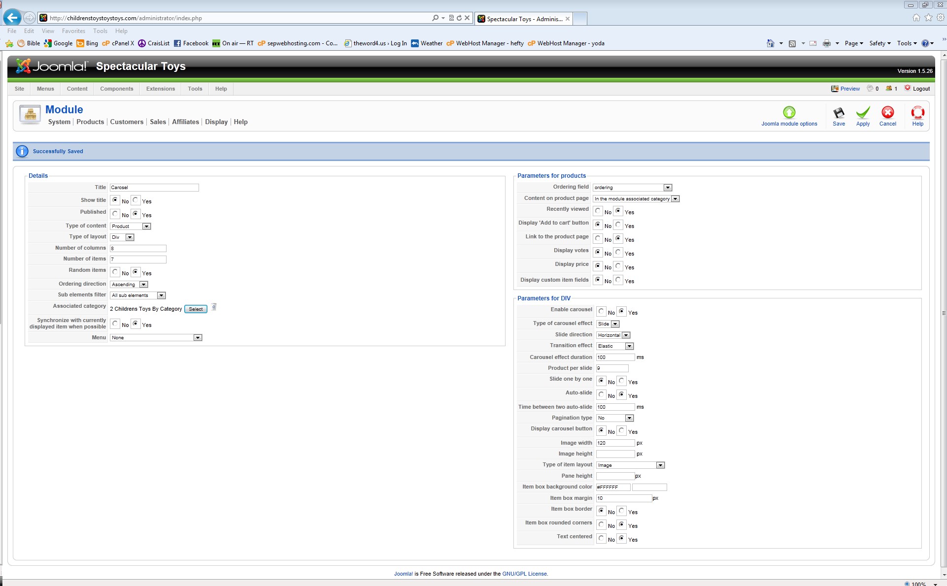

I dont understand what I am doing wrong, I have it set up as it says in the "Infinite slide" documentation I actaully think I used the exact paramaters? Any Help would be appreciated. Thanks.
Dave
Last edit: 14 years 1 month ago by davemalton.
  • Posts: 86045
  • Thank you received: 14176
14 years 1 month ago #54456

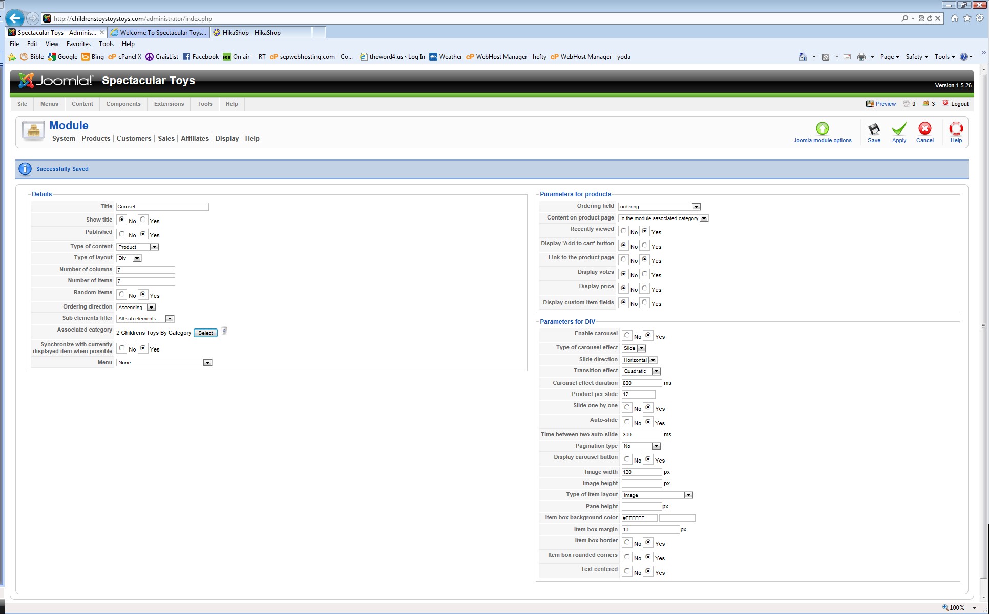

Could you do a screenshot of the options of your module ?
  • Posts: 47
14 years 1 month ago #54582
its added.
Dave

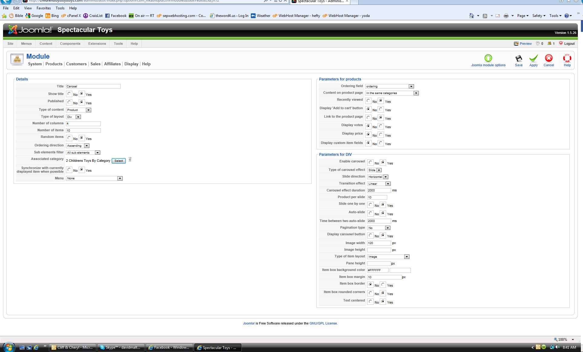

  • Posts: 86045
14 years 1 month ago #54607
You set a number of "product per slide" to 10, while you have 4 columns and 10 products per page. So that normal that it displays like that. Change the "product per slide" option to 4 and you should have something closer to what we have in the demo website.

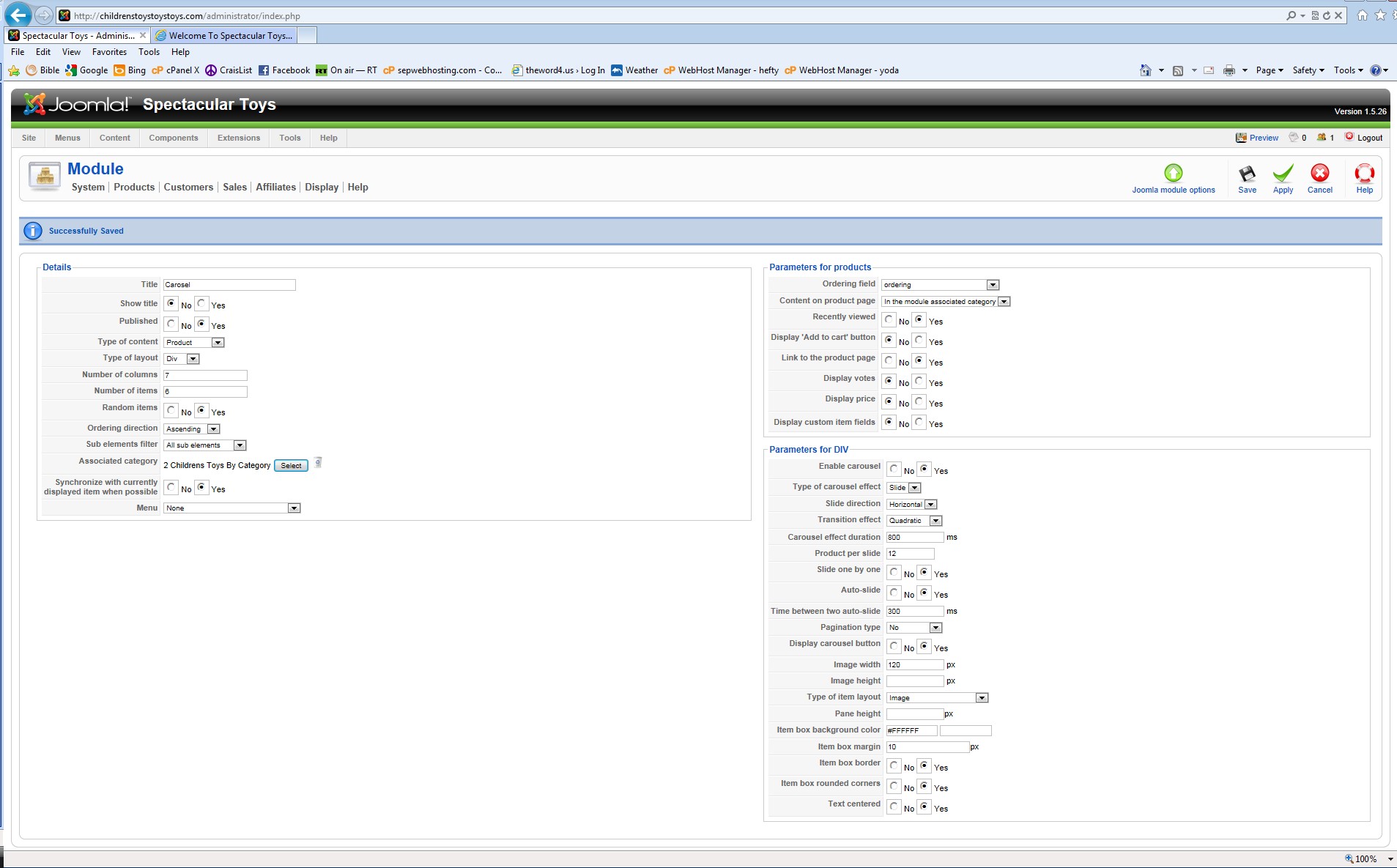

  • Posts: 47
14 years 1 month ago #54678
childrenstoystoystoys.com/

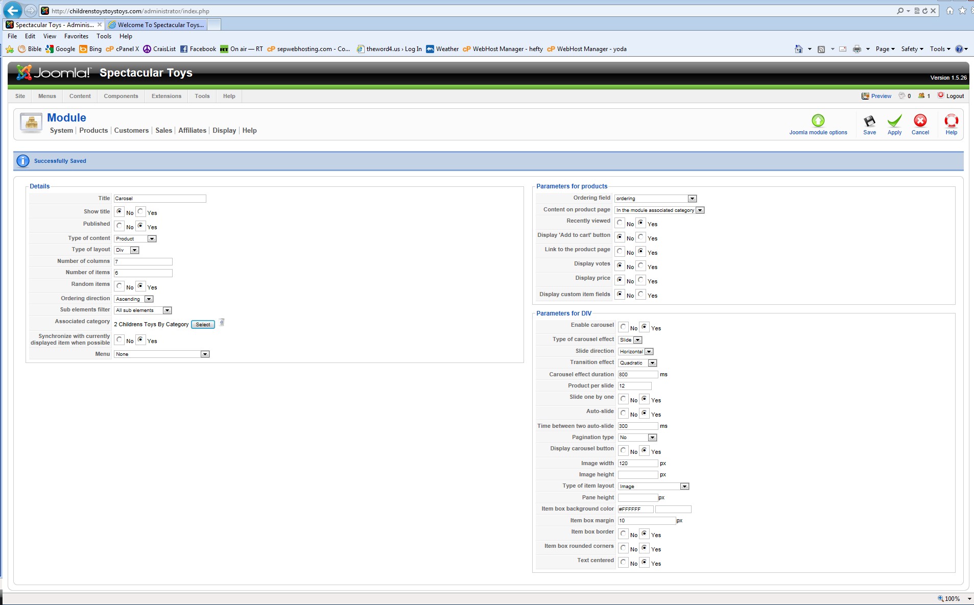

OK it looks more like what you have on your demo site but its not rotating on its own. Attached is another screen shot of what I have the Carosel settings
  • Posts: 86045
14 years 1 month ago #54704
That's normal.
You set a number of "product per slide" to 9, while you have 8 columns and 7 products per page.
So that means that on one slide it will display 9 elements and then it will shift 1 product off and on the slide.
But since you're only allowing 7 products in total for the whole slider, it won't display enough products in order to have a slider.
You should follow the settings of the module on the demo website:
The same number for the "number of columns" and the "products per slide" options and a bigger number for the "number of items" option.
That will make it slide.
Also, as in the demo website tutorial, I recommend that you turn on the "slide one by one" option.

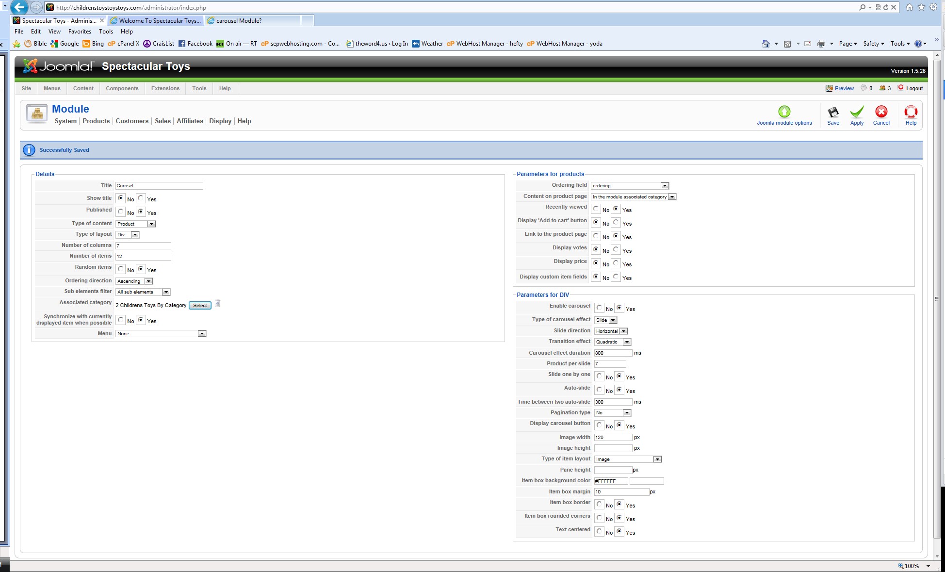

  • Posts: 47
14 years 1 month ago #54954

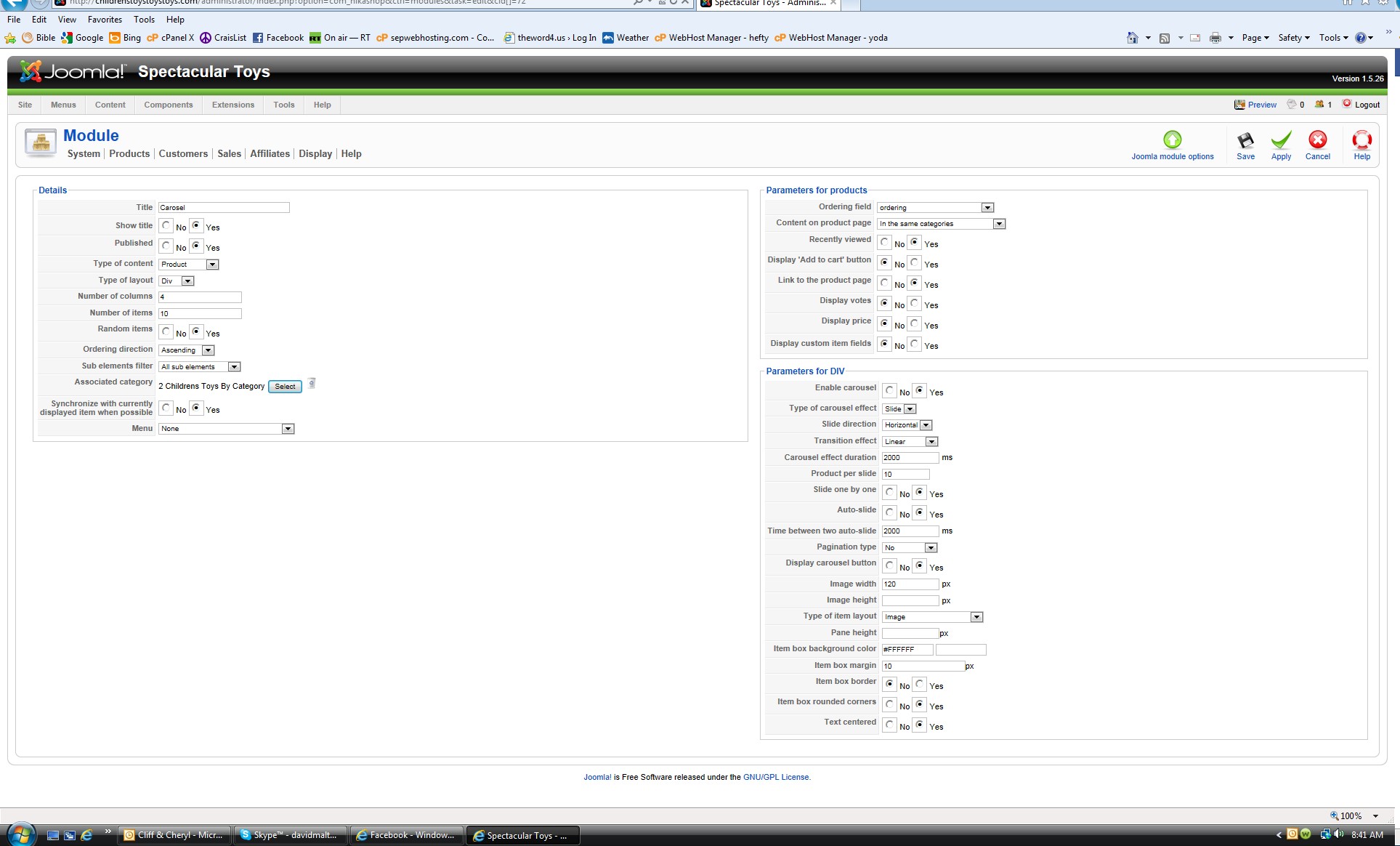

I have tried to duplicate what you have and its still not rotating. File attached
Dave
  • Posts: 86045
14 years 1 month ago #54957
Mmm. I don't know how I should explain myself differently. It's the exact same problem as my previous message.
You need to have same number for the "number of columns" and the "products per slide" options and a bigger number for the "number of items" option. That will make it slide.

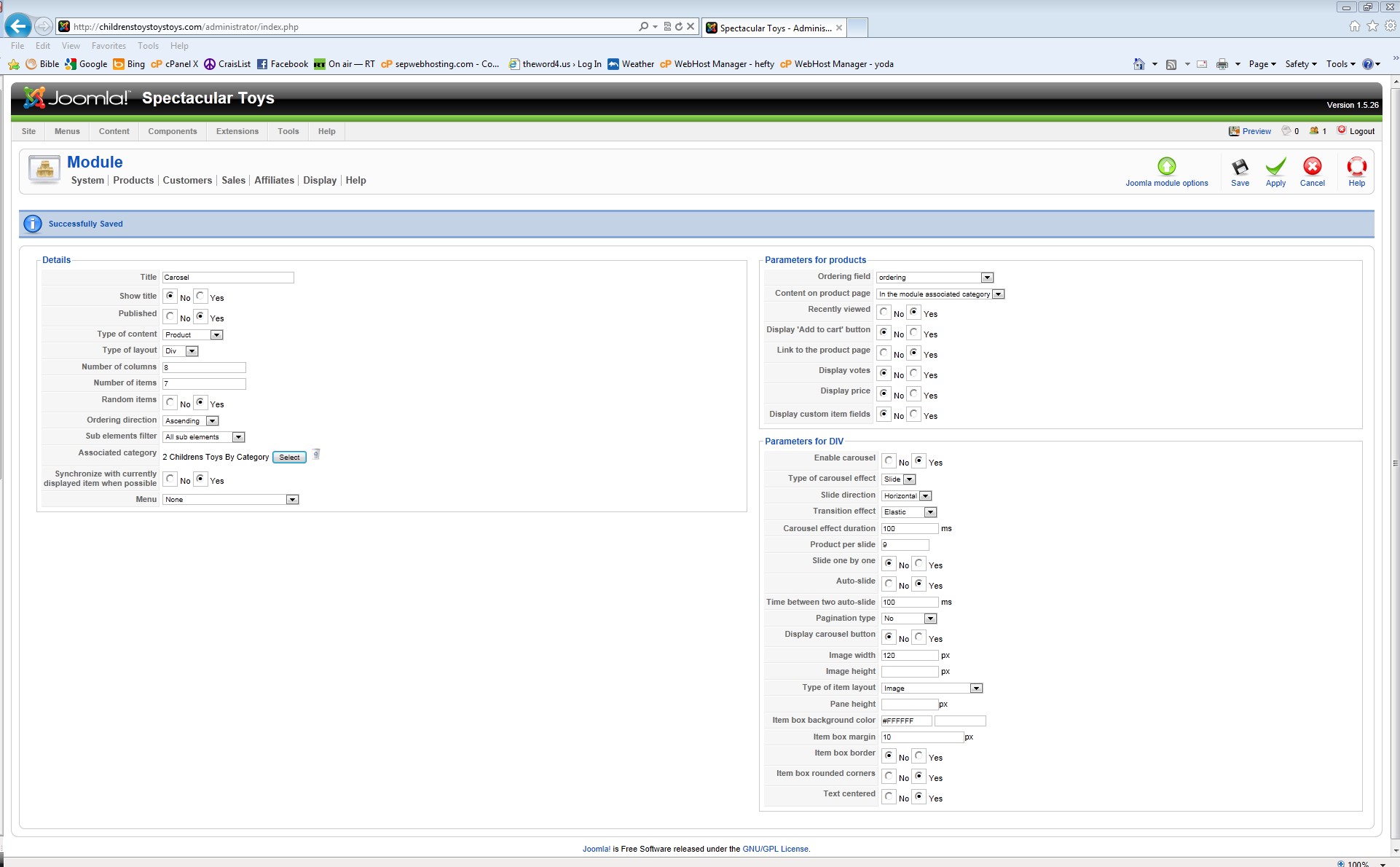

  • Posts: 47
14 years 1 month ago #54958

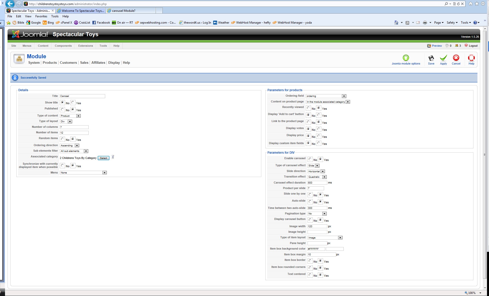

ok go look now at what happens new file attached also childrenstoystoystoys.com/
Dave
  • Posts: 86045
14 years 1 month ago #54960
It's still not set properly. You have :
number of columns : 7
number of items: 7
products per slide: 12
I keep telling you that the number of items option should have a bigger number than the two others...
It should be:
number of items: 12
products per slide: 7

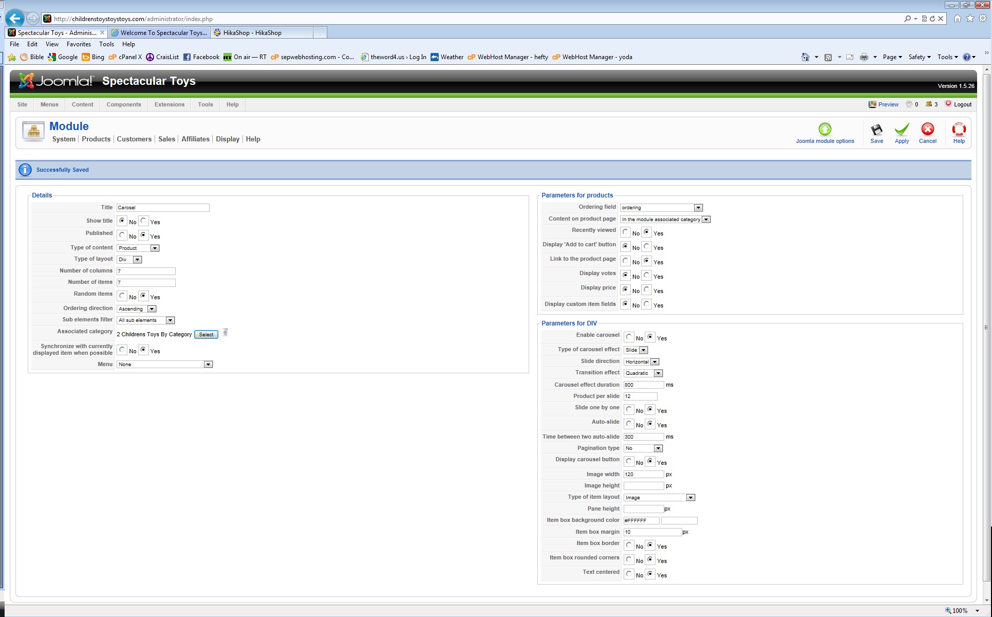

  • Posts: 47
14 years 1 month ago #54963
Is this correct? if it is still not showing up right. Sorry to be a bother :(
Dave
  • Posts: 86045
14 years 1 month ago #54965
Yes, it's good now.
You just need to remove the CSS:
.art-blockcontent-body ul li {
line-height: 125%;
color:
#121517;
margin: 5px 0 0 10px;
padding: 0 0 0 13px;
background-image: url('../images/blockcontentbullets.png');
background-repeat: no-repeat;
background-position: top left;
from childrenstoystoystoys.com/templates/chil...oys/css/template.css and clear your browser's cache.
Your template CSS is interfering with the display of the carousel...
