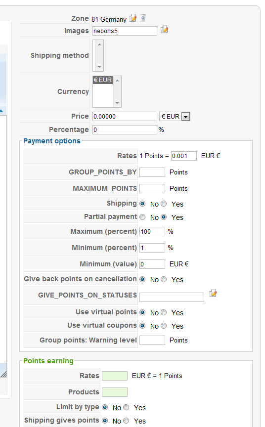

hi Nicolas,
I've installed the latest version - com_hikashop_business_1.5.8_2012-06-20.zip - and I can not see the aup payment method on the front-end. Other payment methods work fine.
I am not sure about the settings in the plugin - see the attachment. Furthermore could you explain the new options like 'Use virtual points' and 'Use virtual coupons' and 'Group points'. I can not find a documentation about it in the aup document.
Thx in advance
Sascha

You should try to remove the zone restriction on your payment method. I suppose that the problem comes from that.
We updated the documentation to add the information on these fields.

Thx for the information.
I removed the zone - unfortunately no changes - can not see aup payment method.

Then, do you have enough points for your user account ? Otherwise, it won't display the payment method during the checkout.

Yes, I have enough points. I would like to give you access to my website. I'll send you a pm.

Could you try to install that version of the alphauserpoints plugin ?
That should solve the problem.
  • Posts: 8
14 years 1 month ago #54802
It's installed. Unfortunately no changes.

It's working fine as far as I can see.

Ah yes, now it's fine. I think it was a cache issue on my side.
