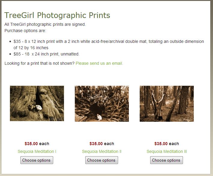

In your last paragraph, I was not asking about the left hand modules. My question is the navigation I set up on the main navigation across the top, the pages (the content in the article where the products go do not show the same as the navigation I have on the left side.
You have the Url in my first question so your see the difference in the two navs.
I have added an image of how the page should look when you click on the top nav. product categories. It does not have the description information only the products.
Sorry to be such a pain. Thanks so much for your help.

What I can see based on your screenshot, is that you simply would like to have the description of the category displayed for that menu. It's quite simple. In the options of that menu, just turn on the "show description" option and that's all.
