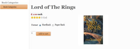

But anyway i copied echo $this->element->product_code; and pasted it elsewhere just to see if I can get the code to appear which it did. My only problem with this is because the products have variations (hardback and paperback) when i click either of the radio buttons the product code then dissapears, so im assuming that once these buttons are pressed its then using a different php file somewhere.
So I guess my questions are now - is there actually a button somewhere that will auto insert my product code into the product listing and if not how can i get my pasted product_code echo line to appear when either of the variant radio buttons are pressed.

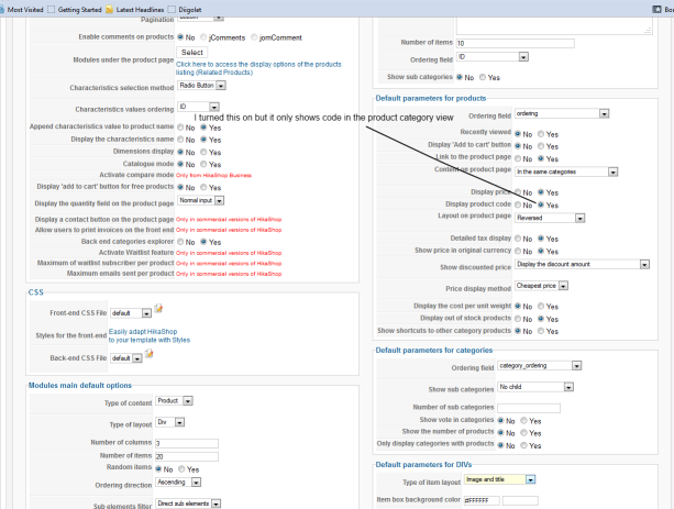

In the Display tab of the configuration, there is a global option "show product code" to display or hide the product code globally in HikaShop since 1.5.8 (it will display on the product page, the invoice, the emails, the order,...)
  • Posts: 55

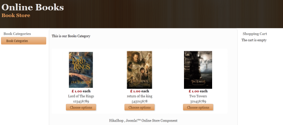

14 years 1 month ago #55436
Thank you for your reply - I had already ticked the show product code - which olnly seems to show the product code on the product category page and not on the actual product page. I have attached some images so you can see - it may be that I have some other settings i need to look at?

14 years 1 month ago #55443
It is on the page but set to not show in the CSS.
Add this to your template CSS:
#hikashop_product_code_main.hikashop_product_code_main {visibility: visible; display: inline;}
