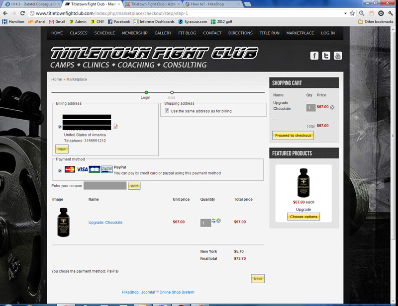

Just converted from Virtuemart and what a difference. Much more user-friendly!
That said, I'm having a problem with the checkout process. When I go to check out, I log in first, then click next. At this point, I can click next a thousand times and it's not going anywhere. I am logging in ok, as my demographic data is populating at the top, but it won't go further than this step. No error messages are displaying, but I'm stuck on this page.
Any suggestions on what to check first?

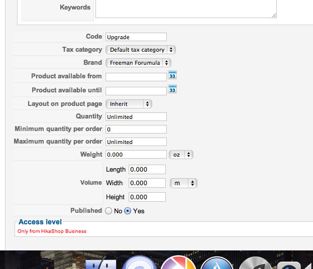

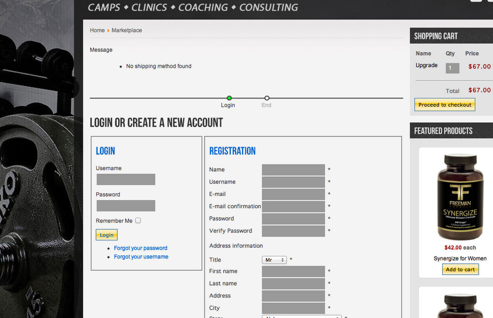

14 years 1 month ago #55677
Thanks, but when I set the weight to zero, I get the "No Shipping Method Found" error. Do I need a shipping method with zero weights to balance it out?

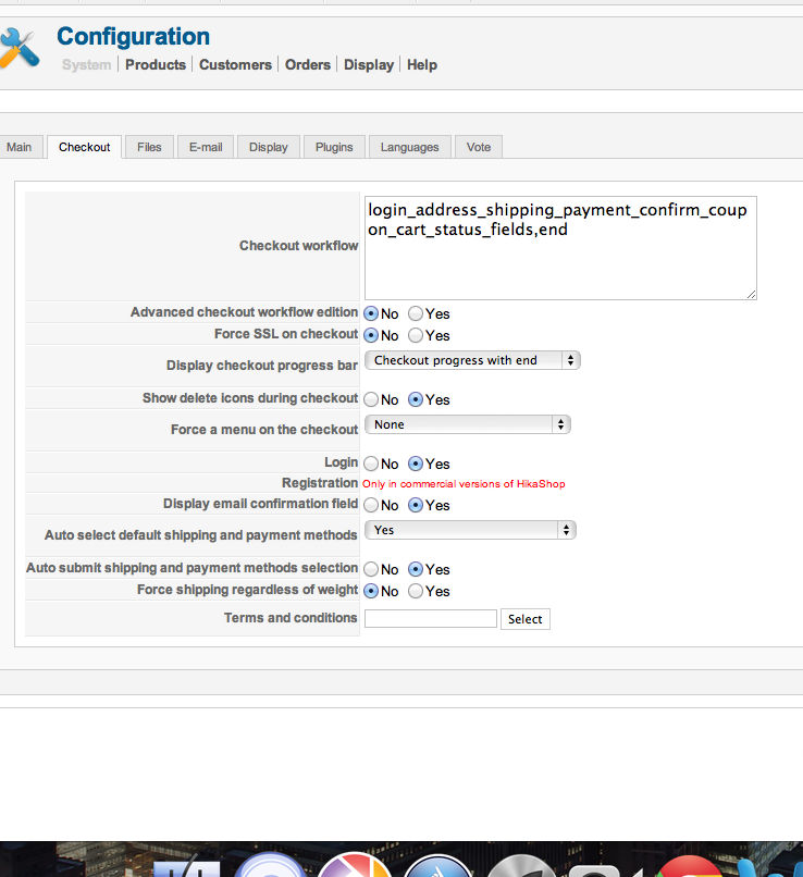

  • Posts: 86058
  • Thank you received: 14182
14 years 1 month ago #55679
No. That's probably because you have the "force shipping regardless of weight" option turned on in the Checkout tab in the configuration.
  • Posts: 5
14 years 1 month ago #55685
No, that one's set to "No". What about select and auto submit on the shipping methods? Does that make a difference?
  • Posts: 86058
14 years 1 month ago #55687
If the weight is 0 for the products in the cart and that option is turned off, you won't get that error.
Other options won't change anything.
  • Posts: 5
14 years 1 month ago #55688
Am I missing something else? Screenshots attached.
  • Posts: 86058
14 years 1 month ago #55690
Mmm. I don't know.
Otherwise, remove the "shipping" view from the "checkout workflow" option of the configuration. And turn off the auto selection of shipping/payment methods option on the same screen.
