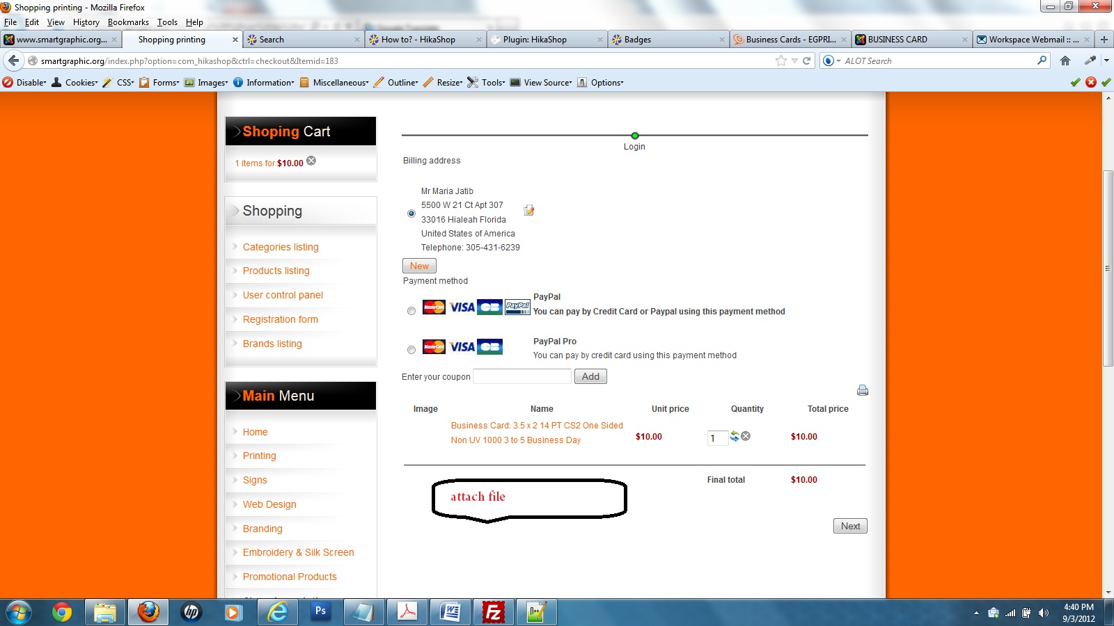

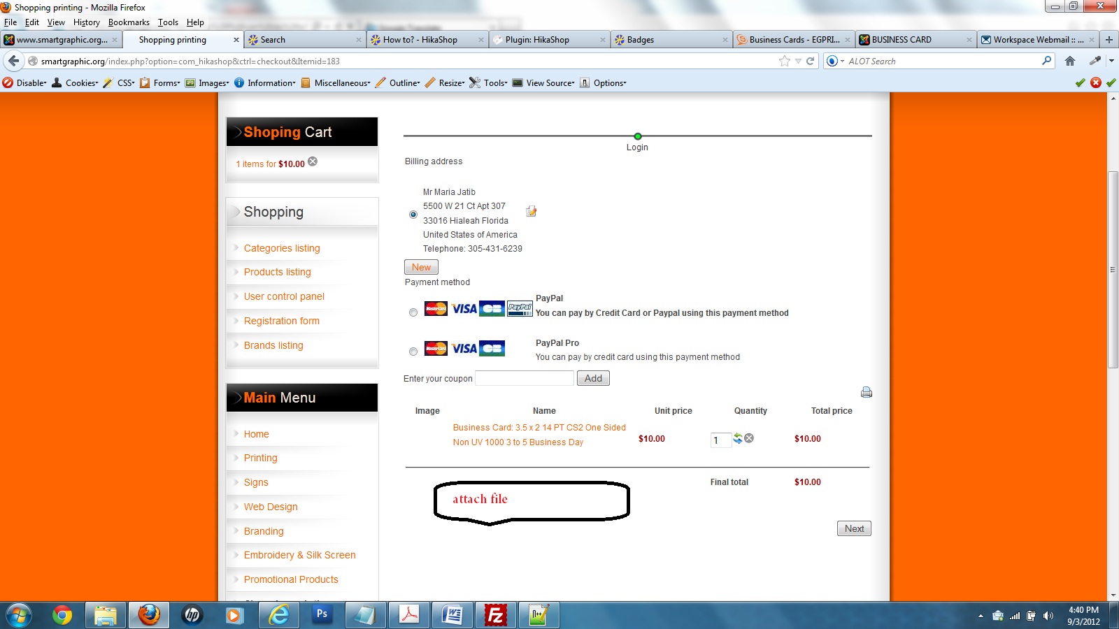

  • Posts: 26
13 years 9 months ago #63576
:( As I can do to make each product added on the shopping cart has a field that allows a file upload jpg, png, tiff etc.
Thanks for you help
  • Posts: 26
13 years 9 months ago #63578
thanks
  • Posts: 85796
  • Thank you received: 14090
13 years 9 months ago #63810
You need to create a custom field of the table "item" and of the type "image" via the menu Display->Custom fields with the business edition.
