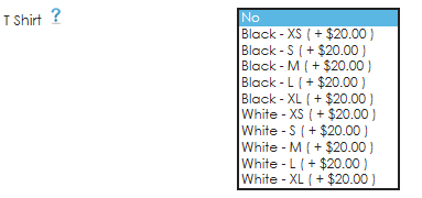

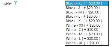

However, in ver 2.2.0, the "T Shirt" option ignores the No variant and displays just the priced variants. (I have "show out of stock products" set to yes in both versions). Pic shows dropdown display where variant No has quantity set to zero - choosing any of the size options successfully adds to the cart.
If I set the quantity of the No variant to Unlimited it shows the No variant in the dropdown but WON'T add any of the priced variants to the cart. Pic below shows dropdown display where variant No has quantity set to Unlimited.

12 years 11 months ago #113962
Thank you for the report.
As far as I can see, the variants of options without quantity have never (for 1 year at least) taken into account the "show out of stock product" option.
You can change that by editing the file "option" of the view "product" and changing the line:
if(!$variant->product_published || empty($variant->product_quantity)) continue;
to:
if(!$variant->product_published || (!$this->config->get('show_out_of_stock',1) && empty($variant->product_quantity))) continue;
I didn't find any issue with the add to cart on my end, regardless of how I configured the options/product.
