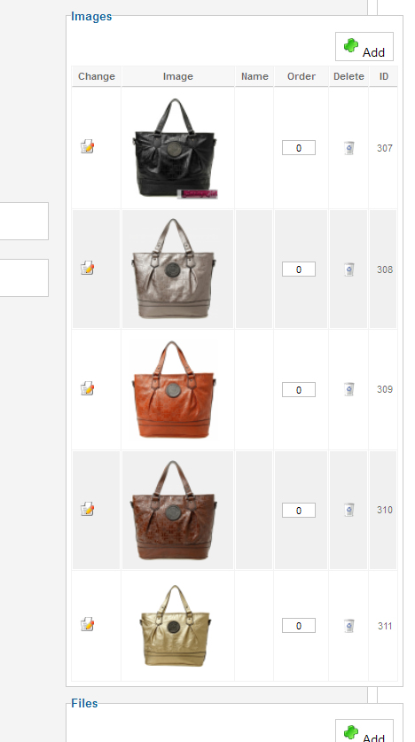

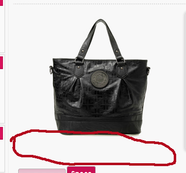

Hello, I have an issue that I can not seem to solve. I added several images to the product, but the thumbnails for the individual images do not show on the product view. I search all the controls, clear the cache on joomla and even turned off the browser and ran ccleaner to see if it help, but it didnt.
Enclosed are images to illustrate the issue. Thanks.

Please configure the order of each image properly:
first one: 0, second one: 1, third one: 2, etc.

Hello, thanks. I did that but it didnt help. I notice that it works just fine before I add characteristics. Once the characteristics are added the thumb nail do not work anymore.

13 years 11 months ago #56485
Your product has variants and each variant has one image.
So the system only display the images of the current variant selected.
If you want all the images to display, please remove the images from the variants of the product and the system will use the main product images with the thumbnails so that users can switch from one to the other.
