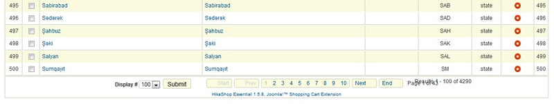

I want to display all the zones, as I want to unpublish the majority and then add only the ones for UK.
I should be able to 'list all' then 'submit' at the bottom of the page, but it keeps defaulting back to 100.

There are more than 4000 zones. If you try to display them all, your page processing will crash.
Because of that, we don't allow you to do that. So it's not a bug. We actually can't change the dropdown itself to remove the "all" choice as it is displayed by joomla.
You actually don't need to unpublish all of them.
Just use the filter on the right to display only all the countries, select them all and unpublish them.
If the country is unpublished, even if its states are published it won't display...
