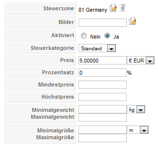

This is what my shipping method in the backend looks like:
The price witout tax is 5,-€ and the tax here is 19%

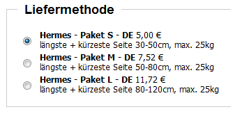

This is what the shipping methode shows on the checkout page:
Here you can see that this is the price witout tax and I want the price with the tax.

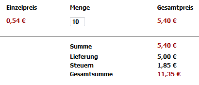

And here you can see the calculation:
Here you can see that the calculation is right, but the shipping costs are displayed without the tax. And thats a problem in germany. Here you have to allways show the price with the tax included.
