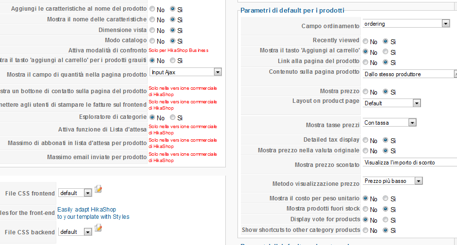

  • Posts: 82
13 years 11 months ago #56449
you can see in my modoCatalogo.png screenshot that display price (mostra prezzo in italian) is set to yes but the price isn't shown on my 'bacio' product....

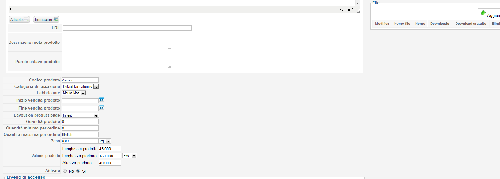

13 years 11 months ago #56555
Can you do a screenshot of the edition page of your product and give a link to that product page ?

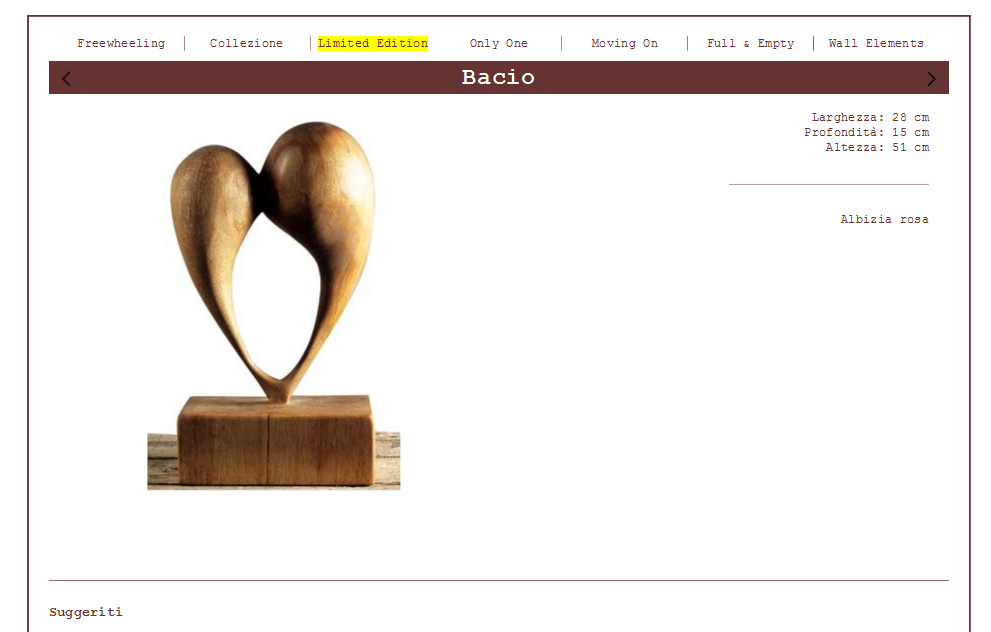

  • Posts: 82
13 years 11 months ago #56848
this is the link.

13 years 11 months ago #56855
I think that he wanted you to do a screenshot of your product page ("Hikashop->Product->'Your product'")

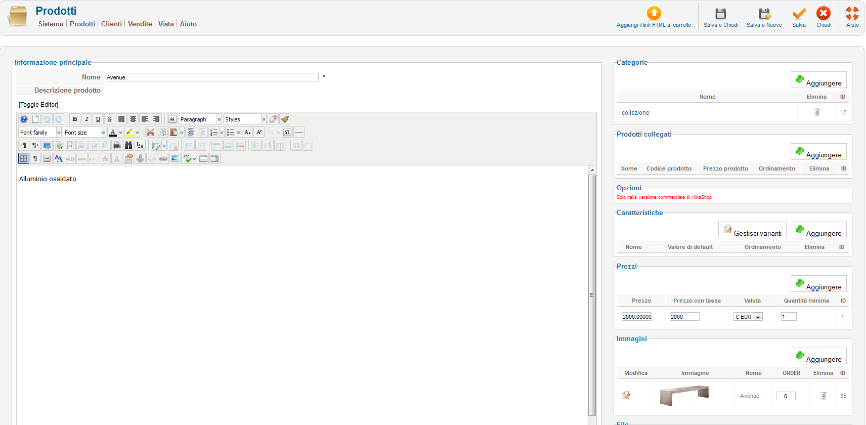

  • Posts: 82
13 years 11 months ago #56856
here they are!

13 years 11 months ago #56875
I think that your problem is coming from your CSS, so you'll probably have to remove the line :
.hikashop_product_price_full{display:none!important}
