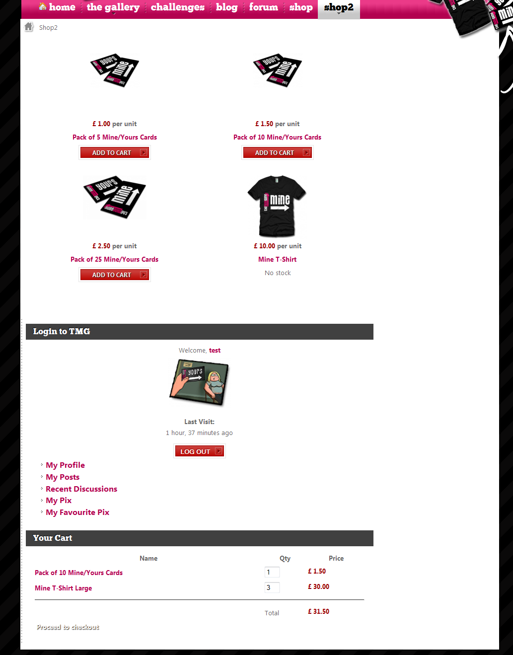

I have just tried a product with 0 stock to show the 'No Stock' message instead of an add to cart button.
The product showed correctly however it has broken my layout, with the sidebar now showing below the main content of the page (see screenshot - Login/Your Cart should be in right hand side bar).
I had a similar problem when I installed the JCE component and had the "Force Container Element" set to "div" so any content without a container was automatically given a div.
Just can't figure out what element is doing this - couldn't come across anyone with a similar problem in the forum.
Simon

15 years 6 months ago #5654
We just checked on our end and the HTML code when there is no stock is ok for us.
Could you provide a link to that page ?

15 years 6 months ago #5665
The opening span is missing in your HTML.
Normally, in the file quantity of the view product (accessible via the menu Display->Views), you should have the span below defined just before the NO_STOCK string:
<span class="hikashop_product_no_stock">
Did you change that view maybe ?

15 years 6 months ago #5669
Ah ok, you're right, the span is there, it's getting late!
However, I can see a closing div tag after the closing div in your attachment:
No stock</span></div><br/>
In our code, in that same file, I don't see it:
echo JText::_('NO_STOCK');
</span>
<?php
<br/>
Could you check this one out ?

Are you sure that you properly added an opening div for it ? Could you attach the content of that view ?
  • Posts: 37
15 years 6 months ago #5674
Managed to sort it - it was the div you mentioned. I had opened it correctly but closed the wrong side of an elseif statement and therefore it wasn't closing when the 'no stock' message was shown instead of a button - must have just stuck it down there at some point to try to make it all work together!
