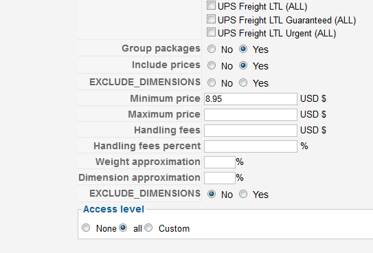

There are TWO EXCLUDE_DIMENSIONS in my screen. Which one do I select? Only one can be set at a time and now my UPS numbers are coming up wrong.
Help!
13 years 10 months ago #60533
Can you test it with the last version of the UPS shipping methode ?
  • Posts: 15
13 years 10 months ago #60574
EXCELLENT! Thanks MT!
