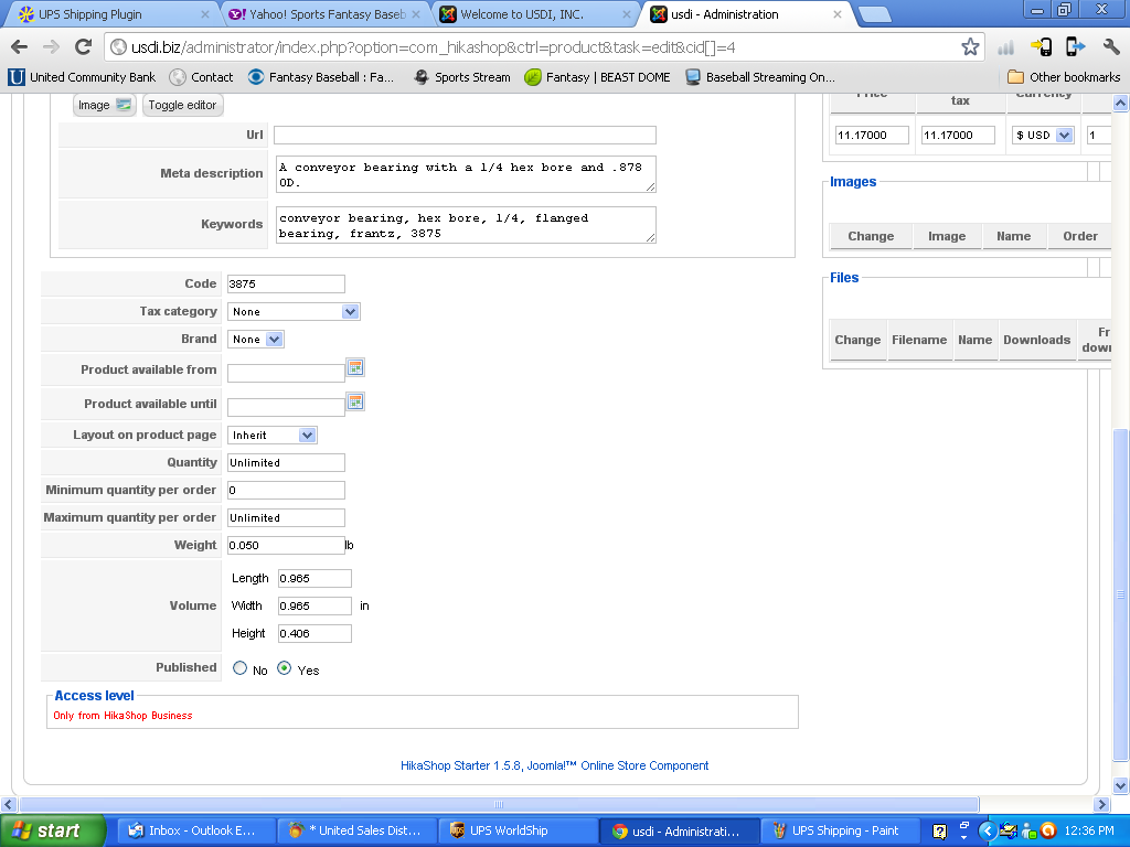

Okay go to the website usdi.biz. In the search bar, search for 3875, that is the product I am playing with. The dimensions are set, the weight is set. The product is less than an inch all around and weighs .05 lbs. Choose quantity 1, and quantity 2. The price jumps when the box only weighs .10 of a lbs.
13 years 11 months ago #56691
It's because the minimum weight that we can send to UPS is 1 LB, so your minimum package's weight will be 1 LB.

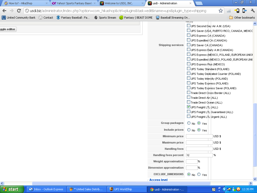

Can you please give me a screenshot of :
- Your product page
- Your UPS shipping page

  • Posts: 23
13 years 11 months ago #56696
  • Posts: 23
13 years 11 months ago #56697
I understand that, so with 2 products, the weight of the package should be 1.05 lbs

13 years 11 months ago #56884
The data that will be sent to UPS will be :
- For 1 product
Weight : 1 LB
Length : 0.965
Width : 0.406
Height : 0.965
- For 2 products
Weight : 1 LB
Length : 0.965
Width : 0.812
Height : 0.965
Everything seem to be alright for me.
  • Posts: 23
13 years 11 months ago #56891
But it is not okay for my site. For this product, the price for shipping 1 item is 9.43 but for 2 items is 10.77. Is there any other areas I should look into changing to fix this problem?
