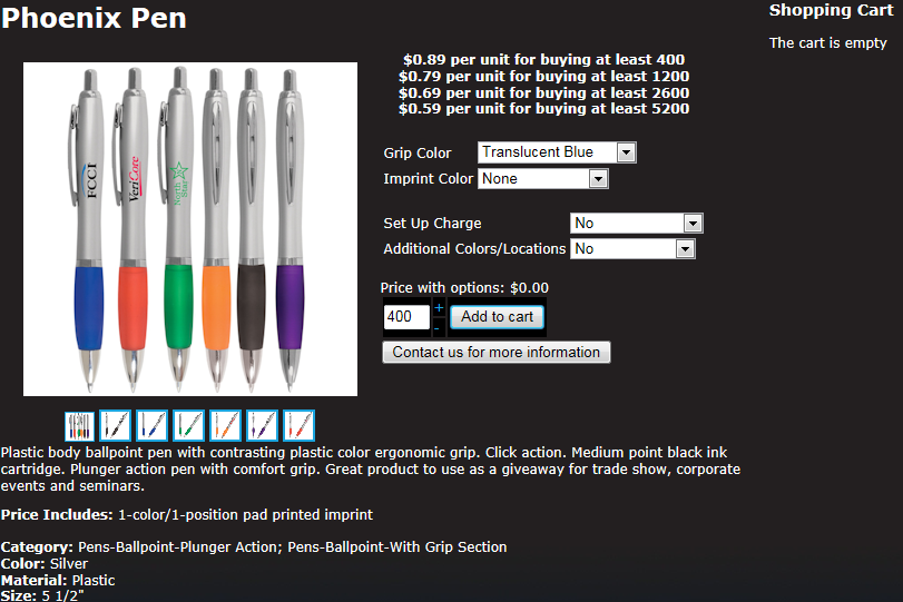

nicolas, as always, thanks for your quick and very useful response. I am glad to know that. I'm attaching several documents. I added a new product to Hikashop--i.e. Hikashop_Main_Page_No_Variants.pdf. With no variants/characteristics, I went to the site and tried adding the product to the shopping cart, which it did successfully--i.e. Hikashop_Product_Shopping_Cart_No_Variants.pdf. Next, I added 2 characteristics (Imprint Color and Grip Color) to the product. Without clicking Manage Variants, I clicked the SAVE button. I went to the site and attempted to add the product to the shopping cart. The first thing I noticed when I went to the site is the quantity was not showing the minimum quantity I specified--i.e. 400, as seen in Hikashop_Product_Display_With_Variants_Wrong_Quantity.pdf. Even if I type in "400" and click "Add to cart", it will not add the item. To get this working, I've had to click MANAGE VARIANTS (seen in Hikashop_Main_Product_Variants.pdf) and replicate the information I entered on the main product page--i.e. specifically the MINIMUM QUANTITY PER ORDER and PRICES PER MINIMUM QUANTITY (seen in Hikashop_Main_Product_Variants_Number_1_Fix.pdf). Once I duplicate this information and save it, I can go to the site, select the product and have it added to the cart, as seen in Hikashop_Product_Shopping_Cart_With_Variant_Fix.pdf. I only did the fix for the first variant--i.e. Translucent Blue Grip Color and Dark Blue Imprint Color. If I select another combination, the quantity field will revert back to 1.

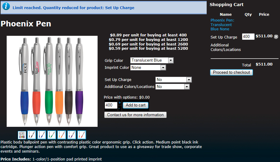

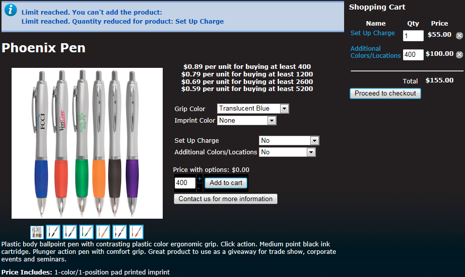

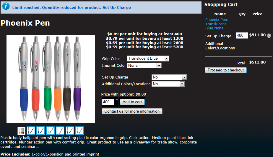

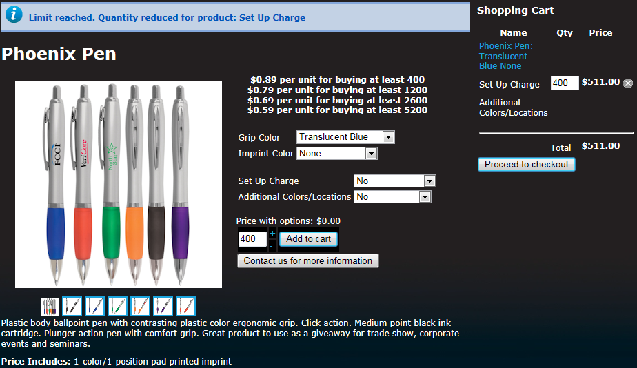

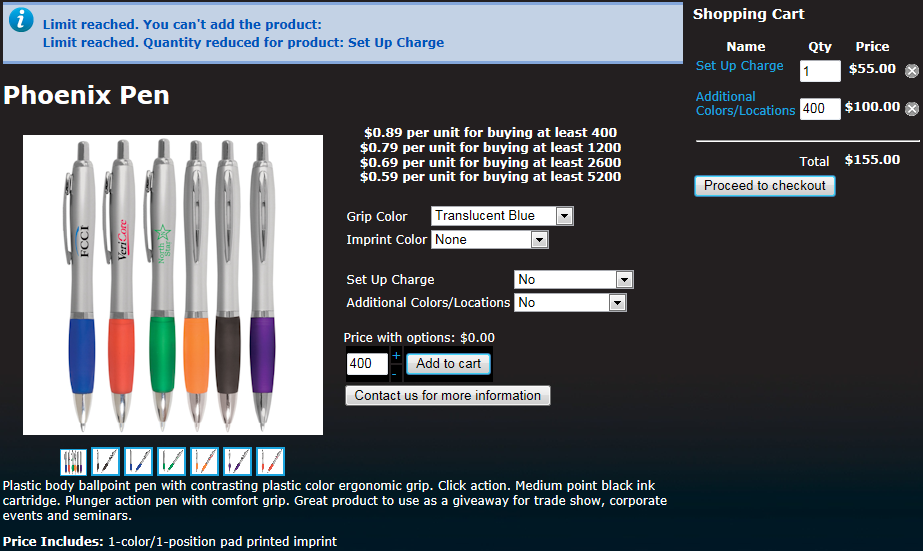

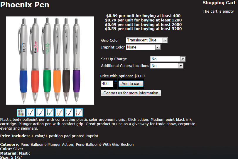

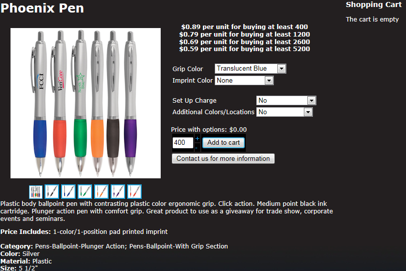

nicolas, thanks again and glad to know this was a known issue. I'll look forward to the official release. I copied the 2 files you attached to my site, unfortunately it still does not work. The one positive is the minimum quantity is always set correctly when I view the product on my site (Hikashop_Product_With_Variants_Correct_Quantity.png). When I attempt to add the product to the shopping cart, I get the "Limit reached. You can't add the product: <variant_name>". It does add the Options with the correct quantity to the shopping cart but not the product (Hikashop_Product_With_Variants_Shopping_Cart.png). I removed the variants from the product, saved the changes, went back to the product, and re-added the variants; but it made no difference. To fix, I still have to go to MANAGE VARIANTS and replicate the MINIMUM QUANTITY and PRICES PER MINIMUM QUANTITY (Hikashop_Product_Manage_Variants.pdf). Once this is done, I can go to the site and successfully add the product to the shopping cart.
NOTE: The "Limit reached. Quantity reduced for product: Set Up Charge" message seen in the attached is correct. The set up charge is a quantity of 1 per order. Since I'm adding a quantity of 400, it's just letting me know it could not add a quantity of 400 for that 'product'. I'll remove the display of the message before the site goes live as testers have already commented on seeing the message and thinking there was a problem.
