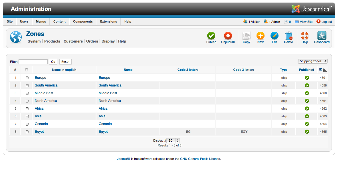

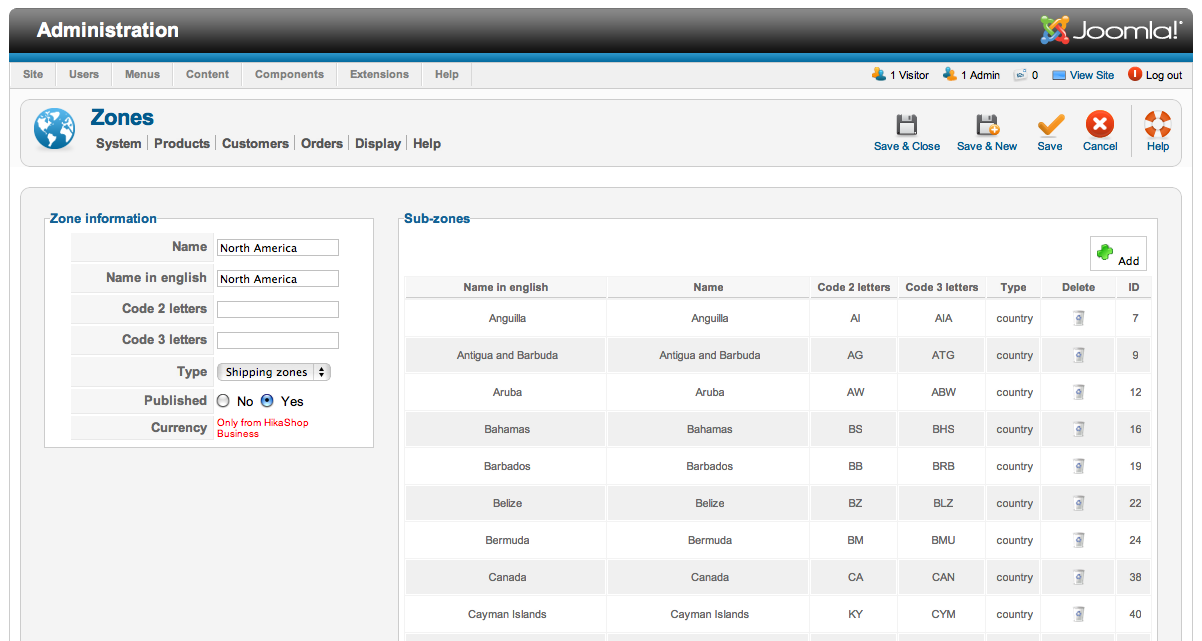

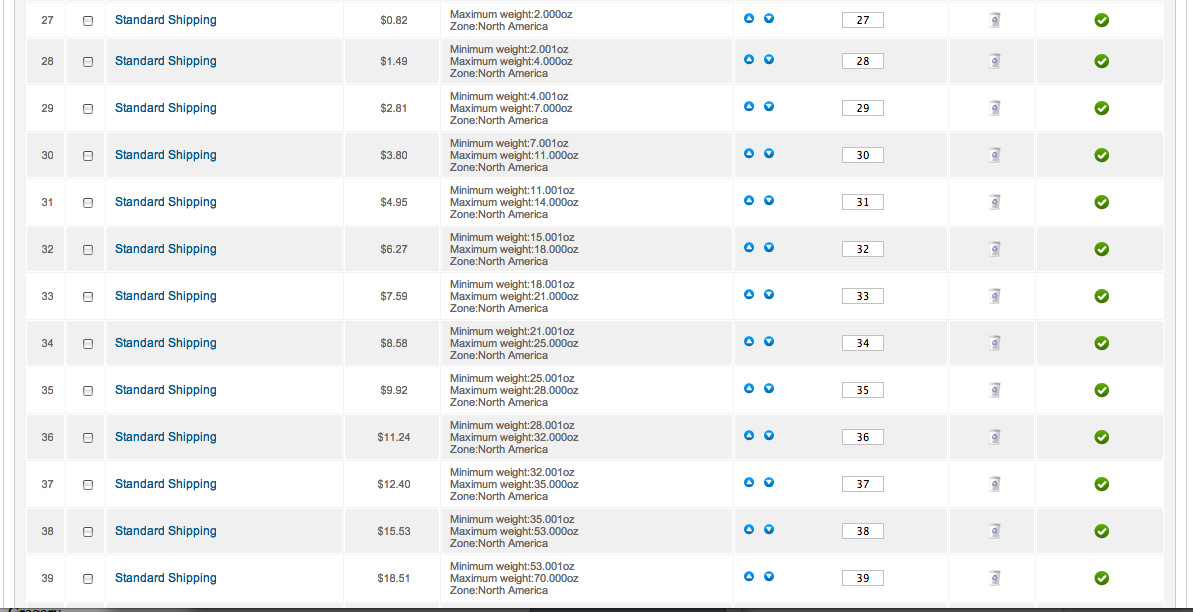

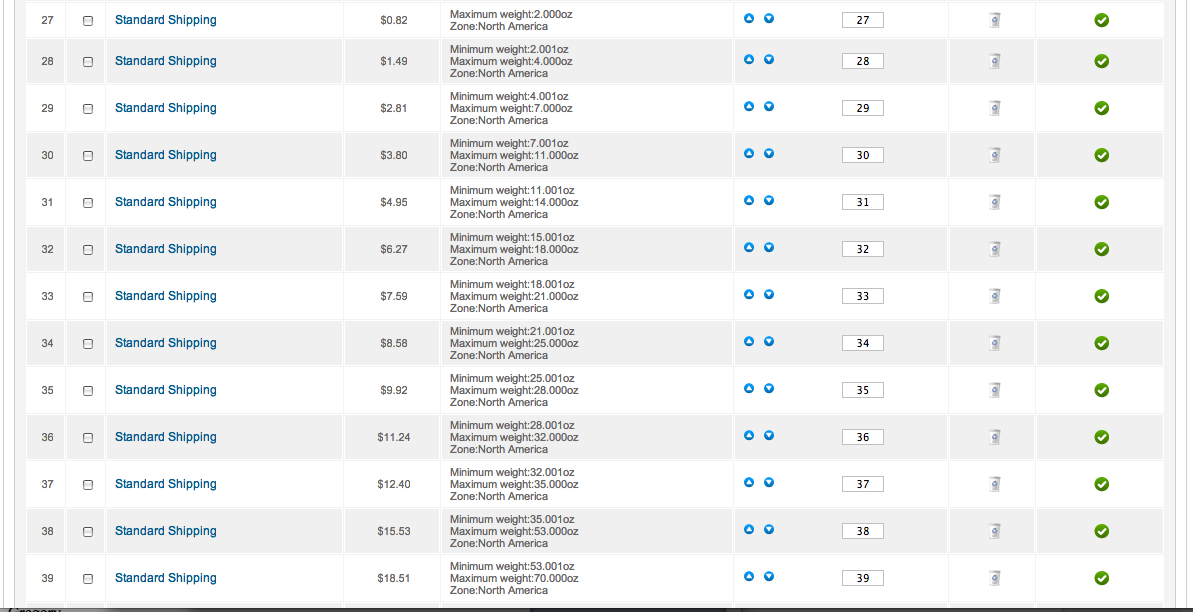

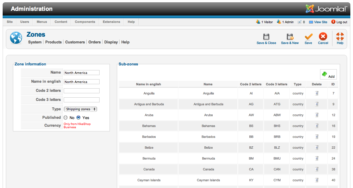

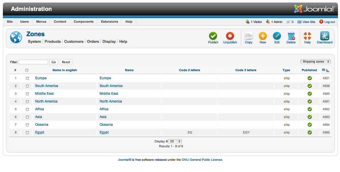

I've created shipping zones with sub-zones for each destination (see screenshots). Then, I created all the shipping methods in the manual shipping plugin, with variables based on zone and price by weight. However, I'm still getting the "No shipping methods available to your location" error message. I've checked and double-checked every item on the list of possible problems ( www.hikashop.com/en/support/documentatio...ins-listing.html#faq ) and everything seems to be configured correctly.
When I remove the "zone" parameter, the shipping seems to work fine. Have I done something incorrect in the zone configuration or is there something else that I've missed?

I have shipping zones set up for the entire world (by using sub-zones within shipping zones), I've tried multiple addresses - in the U.S. and in Egypt - none of them work. It still displays the "No shipping methods available to your location" message. I'm using oz. throughout - on both the manual shipping parameters and for each product.
