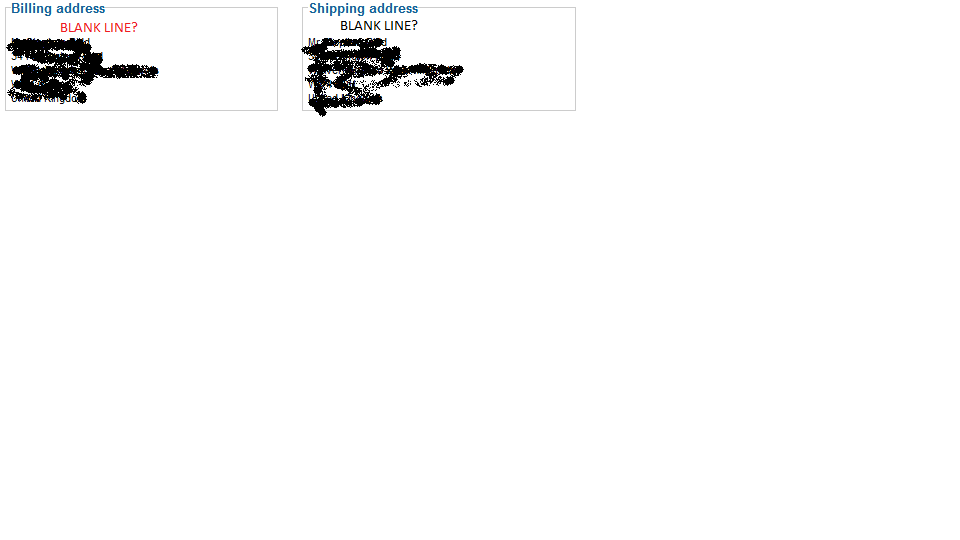

2) The billing and shipping address boxes throw in a blank line after the html legend. I would like to remove this, but can't track down where it comes from?

2: This isn't at the end of the address - it's at the beginning. Attached screenshot.

2. It's the same answer. Check that you don't have any return carriage before the address tags in the address_template files. You can remove the file comment header.

2: SORTED!!!!!!!! I've looked at this for hours and then realised that {address_company} was first line in the view - I don't even capture this! D'oh! Feel stupid lol.
