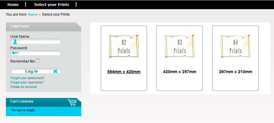

One of my menu pages displays three product categories.
The proceed further the user has to click on a specific text/link (e.g. 594mm x 420mm).
But I would like the user to be able to click anywhere inside one of the rounded boxes (3), but I need help in achieving this?
Thanks.

  • Posts: 74
13 years 11 months ago #57498
Many thanks for the suggestion, however if I have done it correctly I can now link on the text (e.g. 594mm x 420mm) and the image itself.
What I would like to do is to be able to link anywhere within the larger grey rounded corner border box.

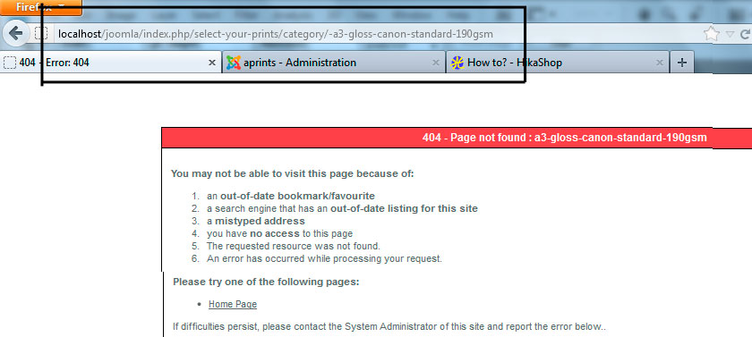

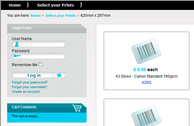

I wanted to do the same in my next level down, where the user selects one of four products by clicking anywhere inside each product box, by copying your code above
change:
<div class="hikashop_subcontainer <?php echo $borderClass; ?>">
to:
<div class="hikashop_subcontainer <?php echo $borderClass; ?>" onclick="document.location.href='<?php echo hikashop_completeLink('category&task=listing&cid='.$row->category_id.'&name='.$row->alias.$this->menu_id); ?>';">
in Display > Views > Product > Listing_Div, but this time I get an error 404.
Can you advice me please what I need to change to make it work.
Thanks.

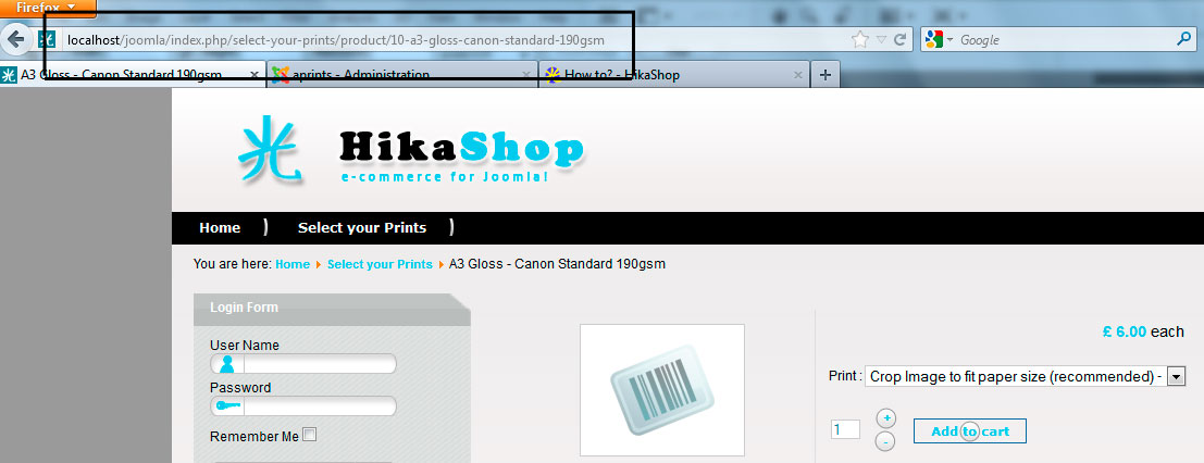

If this helps, I have found the following:
If you click on the actual link 'A3SG' it works correctly, directing you to page (note the URL):
If you click anywhere else inside the box it doesn't work, directing you to page (note the URL):
Many thanks.

13 years 11 months ago #58132
Oh I missed some information in your previous post. The screenshots helped to clearly understand.
You should actually use that code instead:
<div class="hikashop_subcontainer <?php echo $borderClass; ?>" onclick="document.location.href='<?php echo hikashop_completeLink('product&task=show&cid='.$row->product_id.'&name='.$row->alias.$this->menu_id); ?>';">
  • Posts: 74
13 years 11 months ago #58290
