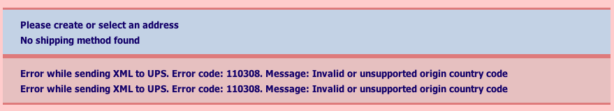

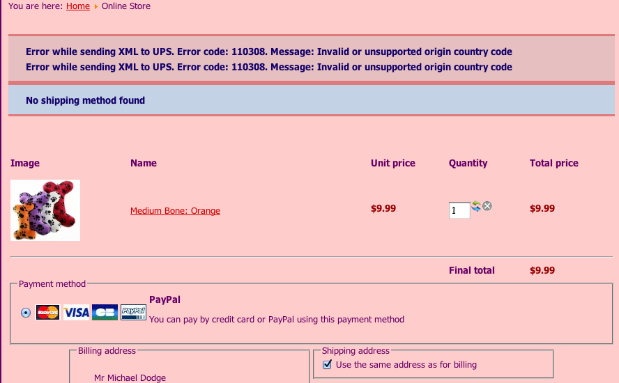

Re: UPS Plugin Error: 110308 unsupported country code
  • Posts: 4
13 years 11 months ago #58178

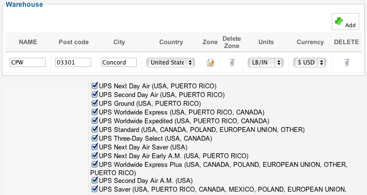

I am receiving this error also.
I have attached a screenshot of my Zone config.

13 years 11 months ago #58193
Do you mean in the Warehouse Config? If so, I have done that and still get the error. I have attached a couple more screen shots.

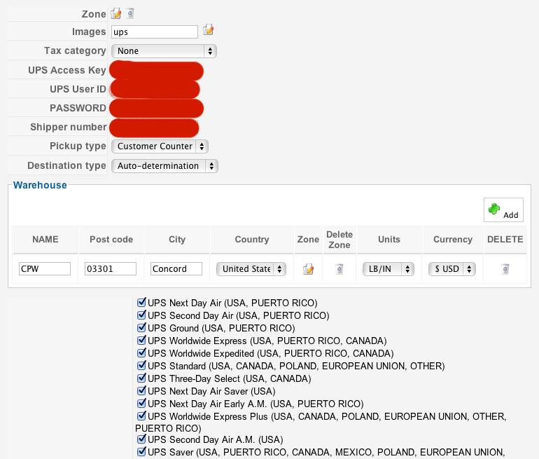

13 years 11 months ago #58207
Okay, I removed the Zone from the UPS plugin (shown in the attached screen shot) but I still get the error.

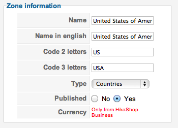

13 years 11 months ago #58266
Please make sure that you selected the zone "United States of America" and not the zone "United States Minor Outlying Islands" in the warehouse country option.
  • Posts: 4
13 years 10 months ago #60007
Thank you! That was the problem. I have a new issue, but I am going to play with it a bit. If I need help, I will start a new thread.
