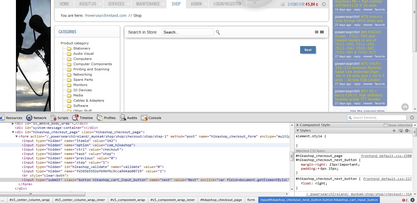

Everything what I do except I add item to cart everything working fine.
If I add item, and go to cart I get a blank page with a "next" button.
If I click there, or refresh the page everything OK.
So the blank page comes immediately after when I add a product to the cart. I looking for the error for 1 day, but dont found. :( Any idea?? Or need more description?

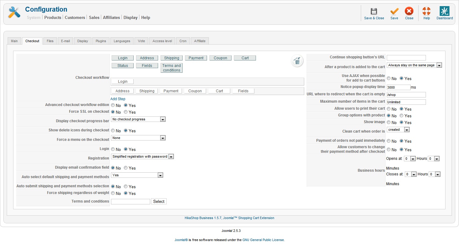

Can you do a screenshot of your checkout options in the configuration and a link to a product page so that we can see the result ?

The problem was what I recently thought but I searched the problem on wrong place. :)
Anyway, I get the blank screen because first step is the login but I'm already logged in. The program go to the first step, but It's empty.
So I checked whether or not the user is logged in, and If its true I go to the next step.
