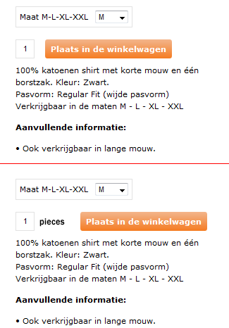

O.k. Clear. Removed the CSS and changed settings. That worked. However what I want is tis, see image:
Si now there is (translated) 1 - putt in bastket.
Butt I want to add a word 'pieces" (stuks) so I get
1 - pieces - putt in basket
I can't find the file(s) to edit.

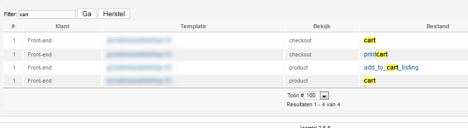

I thought I had to change one of the files (see image) but it is more complex apparently. That's a shame because client insist on the change. I thought I could change the TR in the file and add the text PIECES.
I'll keep on trying!
  • Posts: 86052
  • Thank you received: 14180
14 years 5 days ago #60605
The file administrator/components/com_hikashop/helper/cart.php is a core file, not a view file. You need to edit it via FTP.
