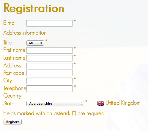

Thanks, the custom_fields override works well. I promised myself I'd never "hack the core" again... I'm still running a Joomla 1.0 website because I did that once. It's always preferable to override the output without modifying a hikashop class. So my solution is pretty much set up now:
- a module to switch the country, loaded with the hikashop country zones and defaults to the geolocated country
- the module switches currency and sets the zone once a country is selected
- the custom_fields override takes the zone info, translates that into a country zone_namekey and sets the address country. Then it simply outputs the country with a flag alongside the state selection.
Still have some adjustments here and there but I think it's pretty much solved. Thanks
