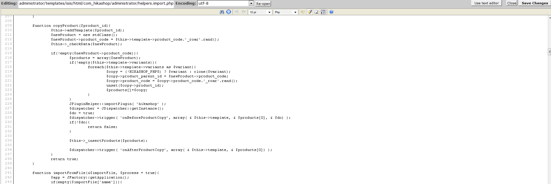

  • Posts: 100
11 years 9 months ago #160323
Hi Nicolas
Could you tell me if it is possible to do an override on import.php. Using the developer information on your website for template overrides will it work for helper files:
/website/administrator/templates/isis/html/hikashop_import.php
Patrick

  • Posts: 100
11 years 9 months ago #160417
HI Nicolas
Firstly really appreciate your assistance.
I have created a file to /public_html/dev_j3/administrator/templates/isis/html/com_hikashop/administrator/helpers.import.php.
I have changed the class name from "hikashopImportHelper" to "roartestOverride" but it does not seem to take effect?
I have also tried class roartest extends hikashopImportHelper but this did not take effect as well.
Could you advise if the location is correct?
Patrick

  • Posts: 100
11 years 9 months ago #160505
Hi Xavier
I am currently using:
Hikashop Version: 2.3.1
Joomla: 3x
PHP: 5x
I changed the name to "hikashopImportHelperOverride" but it still no luck. Can't seem to get it to use the file under /public_html/dev_j3/administrator/templates/isis/html/com_hikashop/administrator/helpers.import.php
Patrick

  • Posts: 100
11 years 9 months ago #160662
Hi Xavier
Yes I am using the isis template for the backend. I have disabled Hathor to make sure.
Again I know this is not a hikashop issue and so really appreciate your assistance...If override works, then it makes Hikashop extremely flexible.
Patrick

  • Posts: 100
11 years 9 months ago #160750
HI Nicolas
Thanks very much for clearing that up.
The final location was as you mentioned
administrator/templates/isis/html/com_hikashop/administrator/helpers/import.override.php
The name of the class in the import.php file was hikashopImportHelper. As Xavier advised, I couldn't rename it but just had to
put Override. In the end the class name used in the override file was "hikashopImportHelperOverride".
Again really appreciate the assistance.
Patrick
